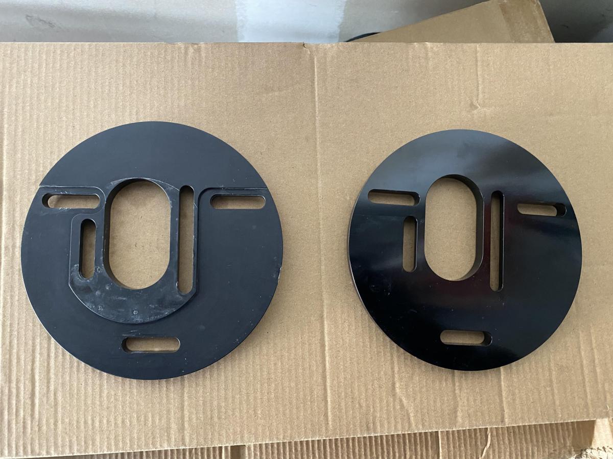

First: the top plate lacks a relief to allow the bracket with the studs to slide under the bearing housing. Old on the left, new on the right:

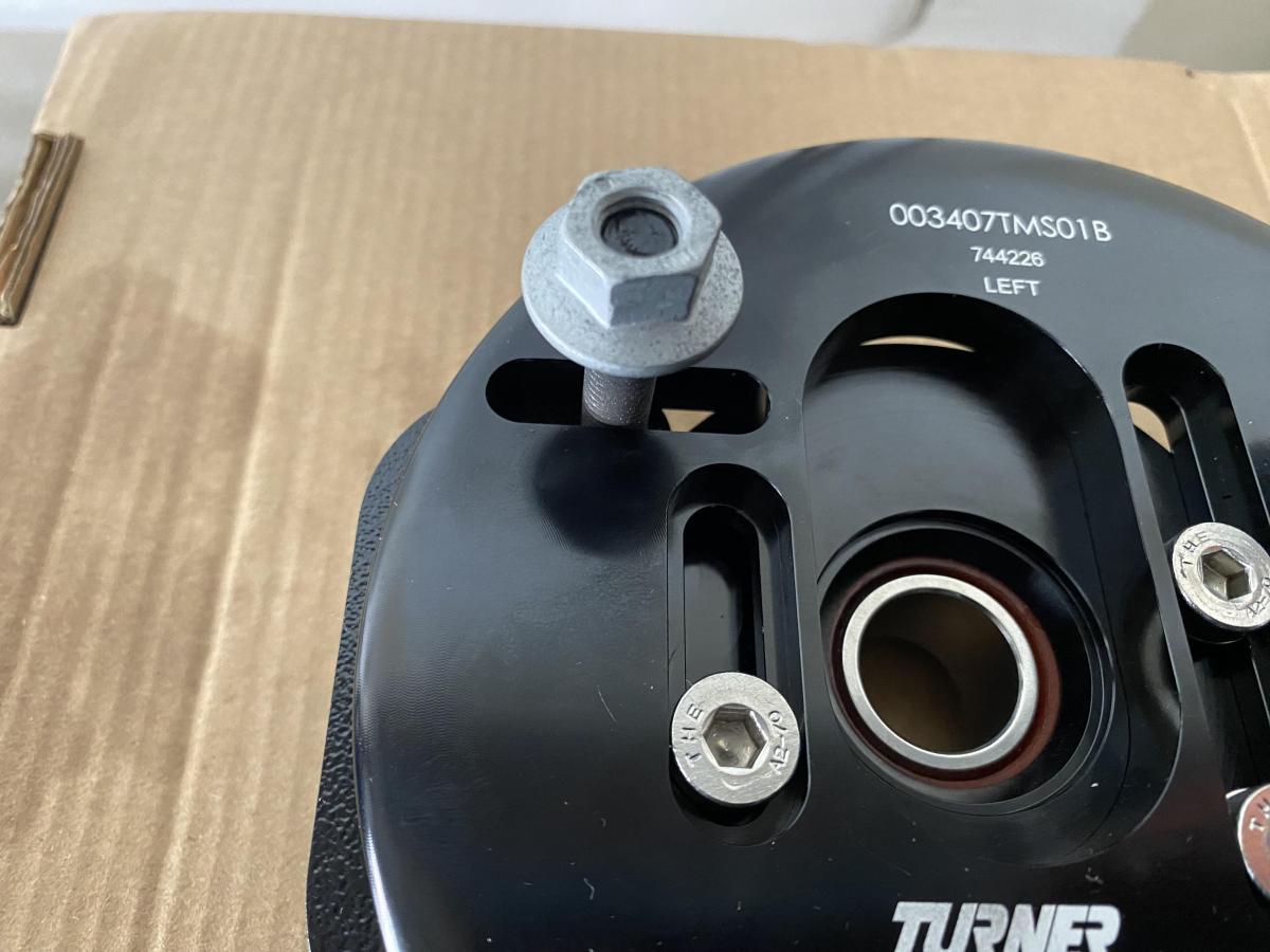

This means there's not enough clearance to allow the full range of camber adjustment. The head of one of the studs interferes with the bearing housing. With the bearing housing fully in place, this is as far as the stud bracket goes:

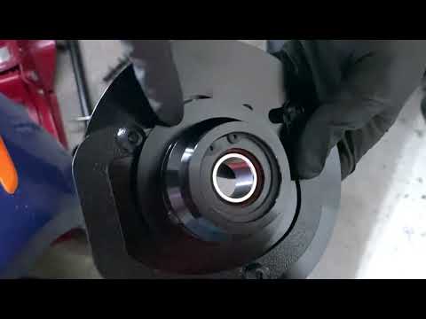

…Unless you loosen the caster adjustment bolts, allowing the bearing housing not to sit flat against the top plate. Hope it’s obvious why that’s not an option.
Though apparently whoever assembled the plates for shipping thought it was an option. When they came to me, each one was assembled such that
1. The head of one of the studs was sandwiched between the top plate and the bearing housing;
2. The caster adjustment bolts were tight so that the bracket couldn’t move; and
3. Because the bolt head was between the bearing housing and the top plate, the bearing housing did not sit flat against the top plate.
So, it was made so it couldn’t be used as described, and then shipped in a condition in which it shouldn’t be used at all.

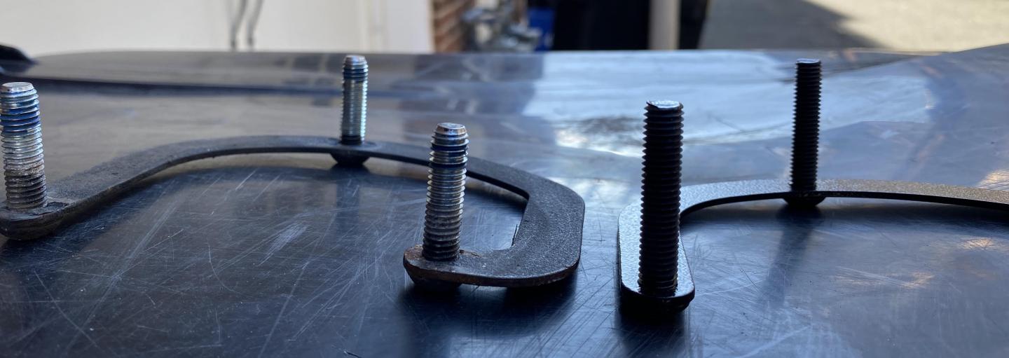

Also, the studs are too long. Old bracket on left, new on right:

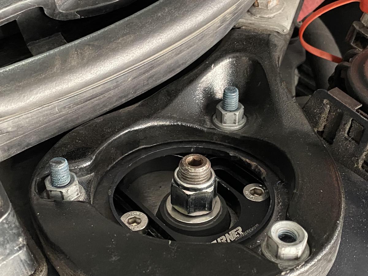

Pic from a partial install (slightly crooked, which is why the third stud isn't completely poking through):
This prevents the stock ///M-logoed dust caps from fitting. Relatively minor problem compared to not being able to adjust camber. But given that most of the point of these plates (vs. the competition) is that they’re designed to prevent dirt ingress, this seems like a stupid problem to have.

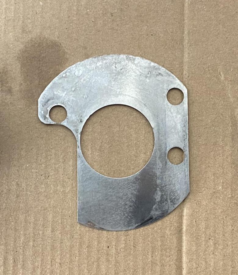

The new kit also lacked this part that sat between the bearing housing and the top plate in the old kit:
Not sure what to make of that.
