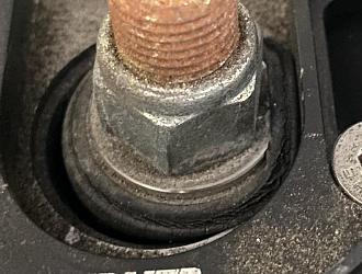

    Originally posted by K-Dawg View Post
    So you bought completely new plates instead of new bearings/seals? Do you have any pictures of the torn seals? I don't like the way the seals in the E46 M3 Hybrid plates work, but they are what they are.
    Correct. Mainly because I didn’t know what was involved, couldn’t find instructions/guidance, and didn’t want to risk another project, more delays, etc.
    Now that I have everything apart, it looks pretty straightforward TBH.
    This is the only pic I have:
    This is of the one with the play in the monoball. The other one wasn’t all smashed to the side like that but its dust seal had similar looking cracks, which turned out to be all the way through.
