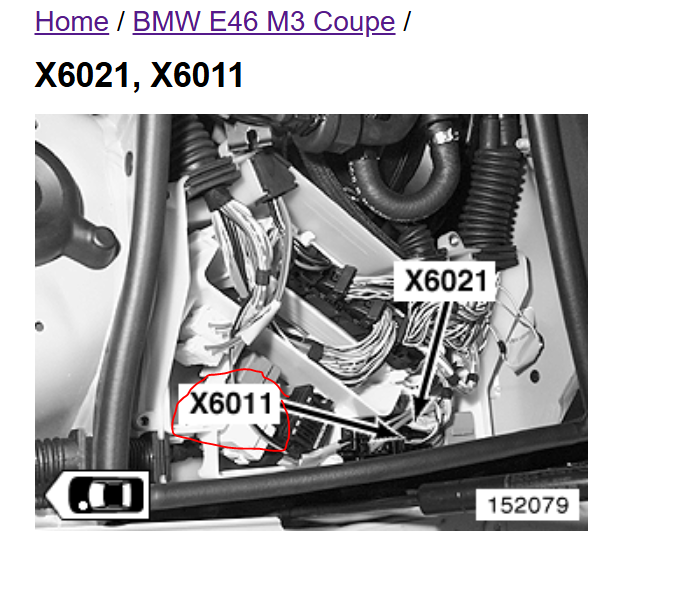

    check for 12v when key turn to crank position at pin1 heavy black wire on the dual row 8pin connector 6011. If no 12v then the issue is upstream at ews or ignition sw; if there is 12v then check the same black wire at the starter connection, or the starter is bad.
