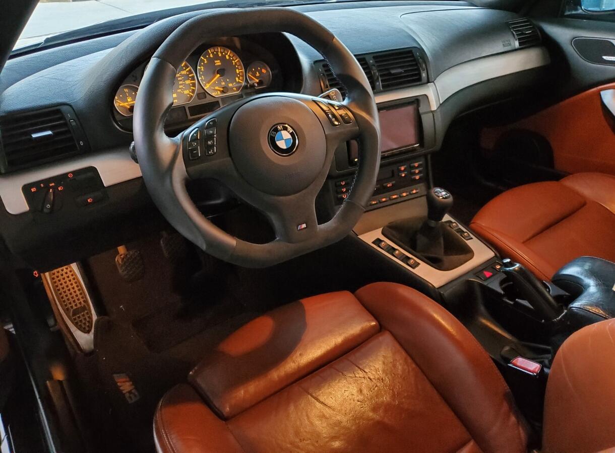

    SSK and Flat Bottom wheel: Since this is where the magic happens, got the OEM kit (can find on ECS or Turner). Came with a ZHP knob…btw, beware of fakes. Bought one on IG for a discount, found out it was fake. Shifts are nice and tight, most of the slop is gone, really is a connected experience. The wheel was off a gentleman on ebay (andri zakus) who custom made the wheel for me, took about 6 weeks to get to me.

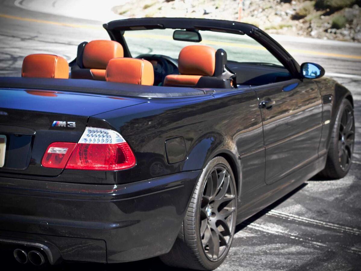

          Hey Dustin! Having this for a while, i'm actually quite pleased with the setup! Overall, i paid roughly $750 new (had some sales back then) and it was a straight swap, didn't add anything. I like the ride, i spend a lot of time on SoCal freeways and it isn't too jarring, its firm and compliant at the same time (for some of these roads, its almost impossible to make up for how bad the roads are sometimes). I've tracked it a few times and did well, it's a good all around setup. drop isn't that bad, the rear goes down more than the front.

              That first pic is so beautiful. Nice color combo too, first e46 m3 I ever sat in was black/cinn.
                Thanks! Corona Hills FTW!
