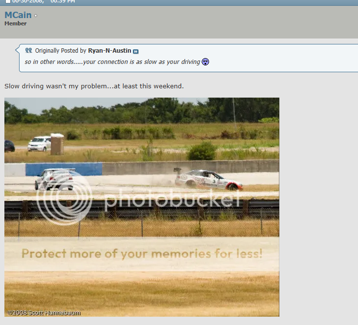

                    Here are those wheels possibly in use in 2008...
                    Let's see how many more laps they have left in them.
