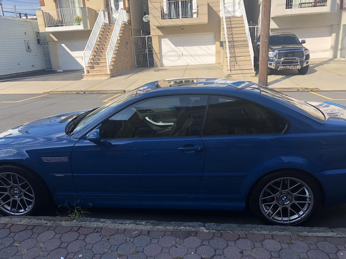

    Since I live in a congested area (North Jersey) and park on the street I decided I was going to target a car in the late to mid teens and stay away from the garage queens. Made much more sense, based on my situation, to spend less on the purchase price, and use the money I save to put into maintenance items and build the car into the one I always dreamed of.

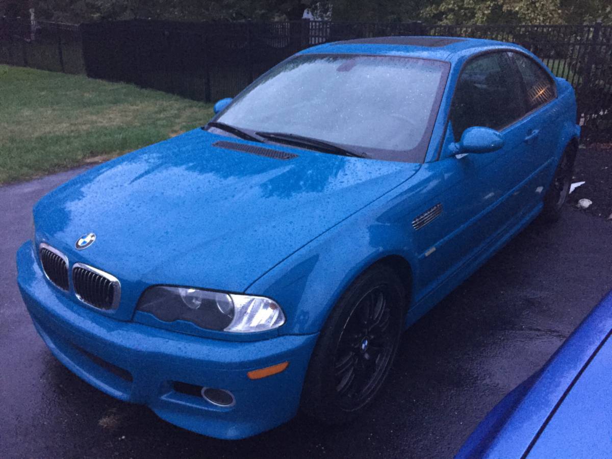

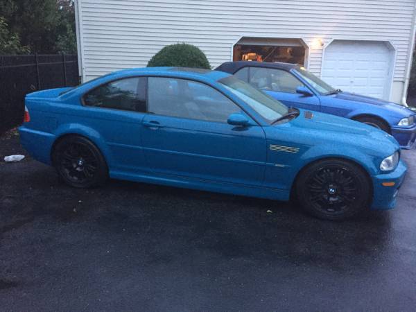

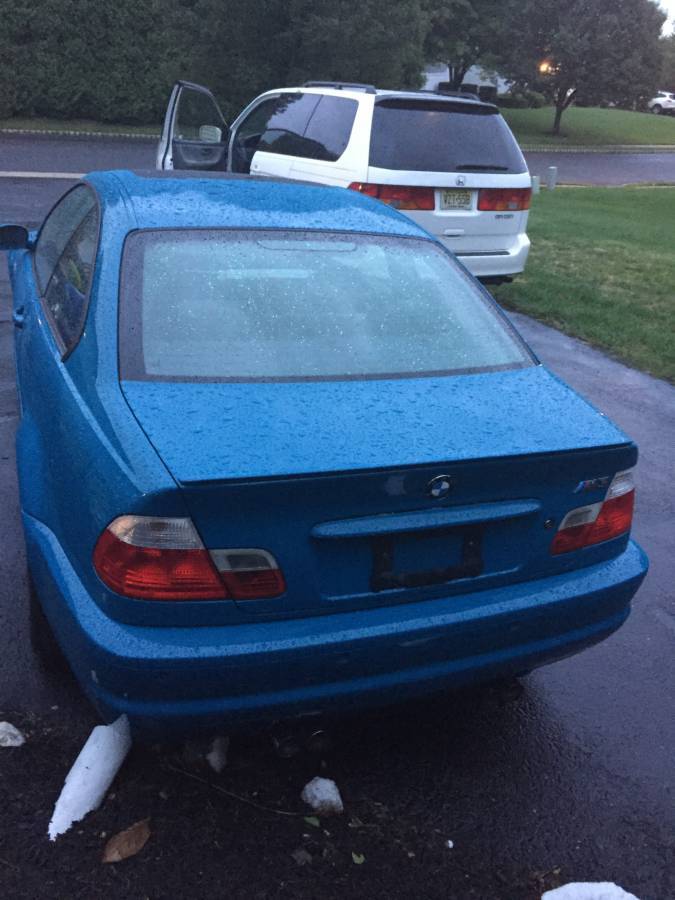

    After seeing 2-3 cars that were a disaster, I saw a 2003 SMG in Laguna Seca Blue with 81k miles pop up on Craigslist. I ran the vin and saw it had 5-6 owners!! Nevertheless it was priced below KBB and it wasn't a far drive away so I went to check it out. After looking it over and taking it for a test drive I decided I had to buy it!! The issues with the car were minimal in my eyes and the relatively cheap price gave me some wiggle room to address them.
    Click image for larger version  Name:	image_1191.jpg Views:	7 Size:	31.8 KB ID:	3564
    Click image for larger version  Name:	image_1193.jpg Views:	4 Size:	67.9 KB ID:	3565 Click image for larger version  Name:	image_1192.jpg Views:	4 Size:	73.1 KB ID:	3566 Click image for larger version  Name:	image_1194.jpg Views:	4 Size:	115.4 KB ID:	3567

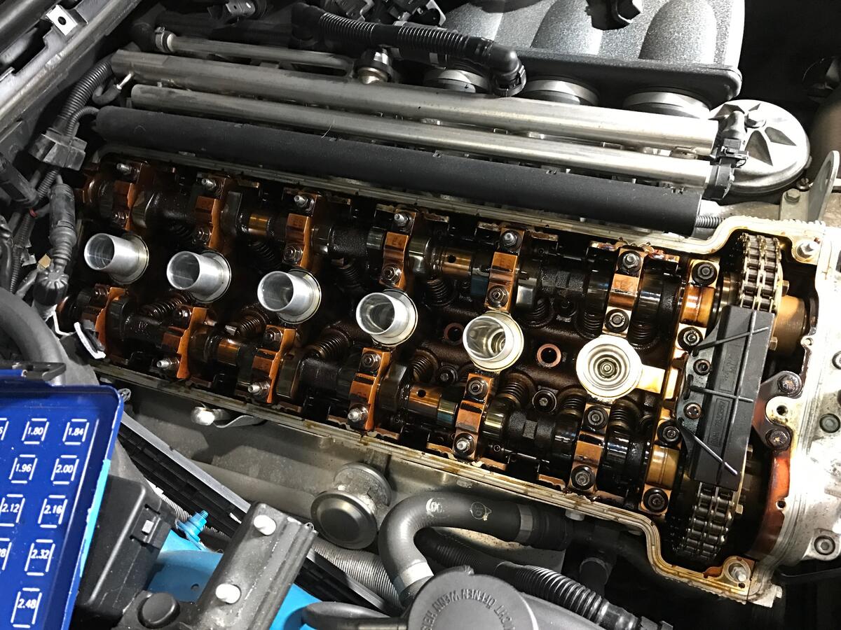

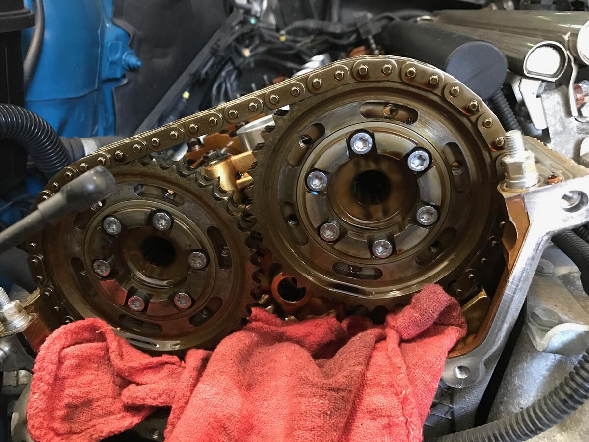

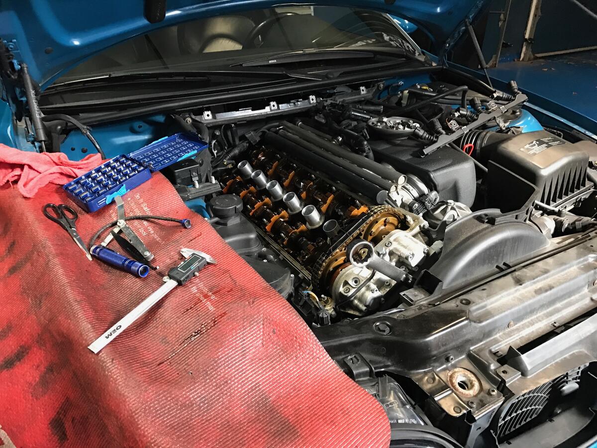

    When the Beisan stuff came in I took the car to Dan the vanos man (xM P0W3Rx) Based on his reviews on the regional threads. He was awesome to deal with and luckily not too far of a drive.

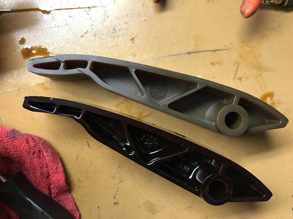

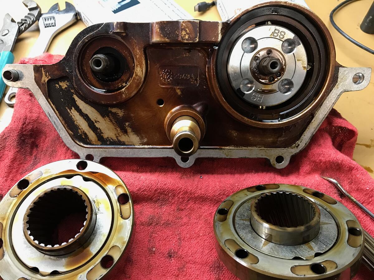

    Dan addressed the following:
    - Valve adjustment (17 valves out of spec)
    - New spark plugs
    - Oil pump disk
    - Rattle repair kit
    - Vanos coil pack, seals, & sealing plate.
    - Vanos bolts
    - Chain guide
    Click image for larger version  Name:	image_1201.jpg Views:	4 Size:	172.2 KB ID:	3569

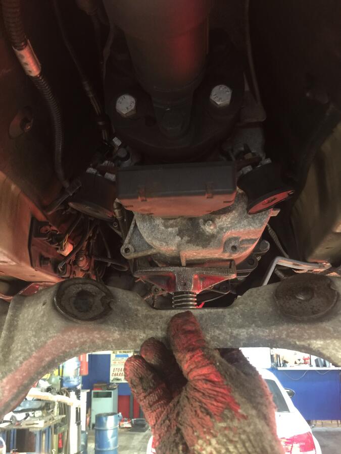

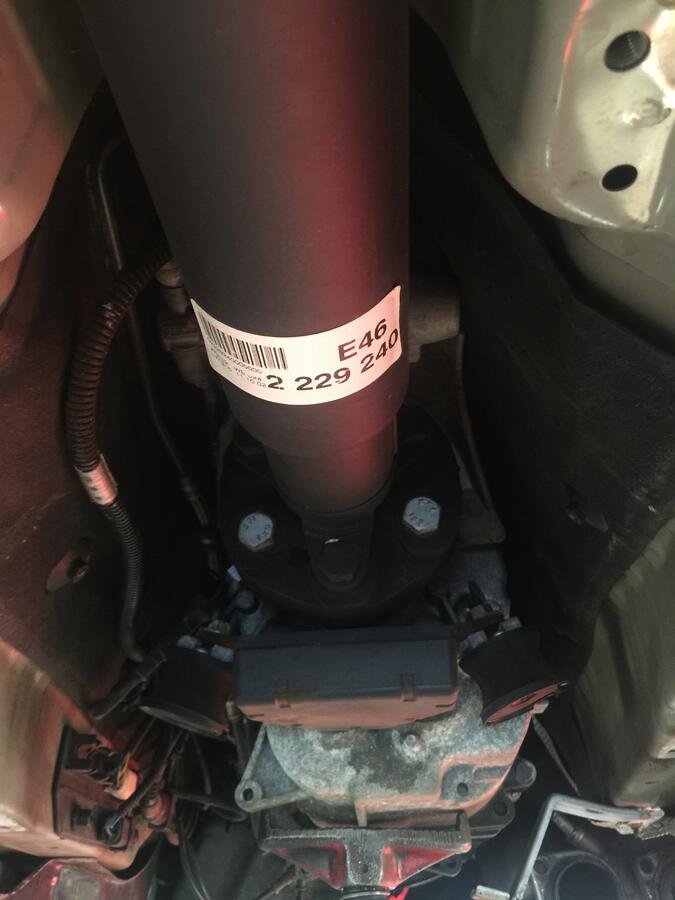

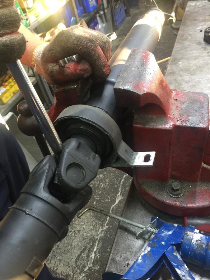

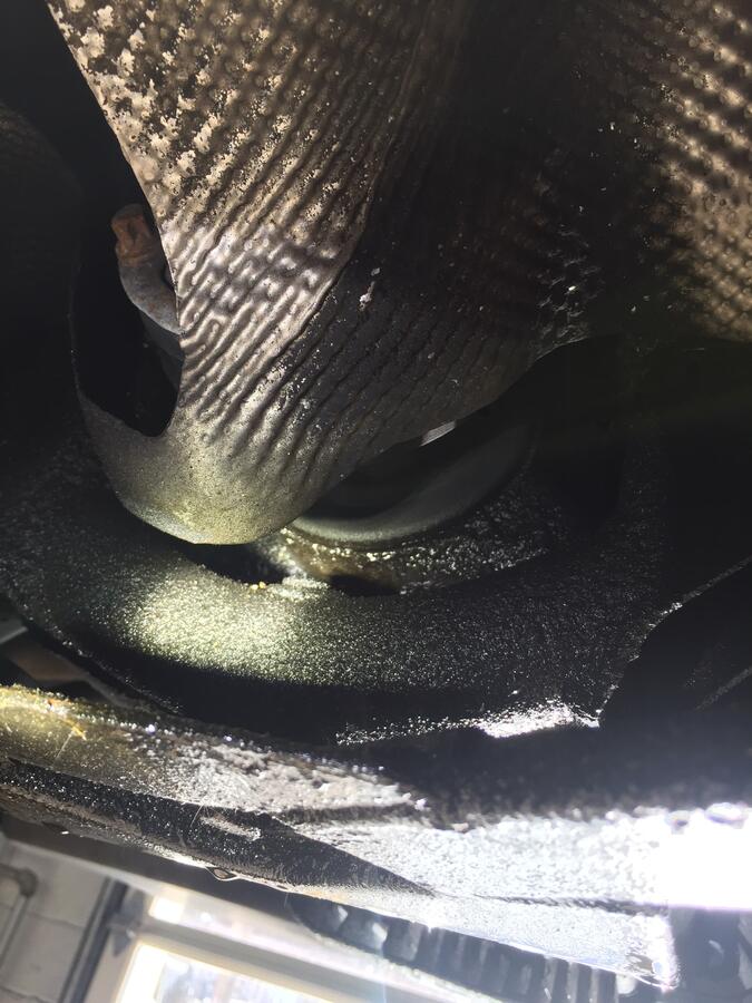

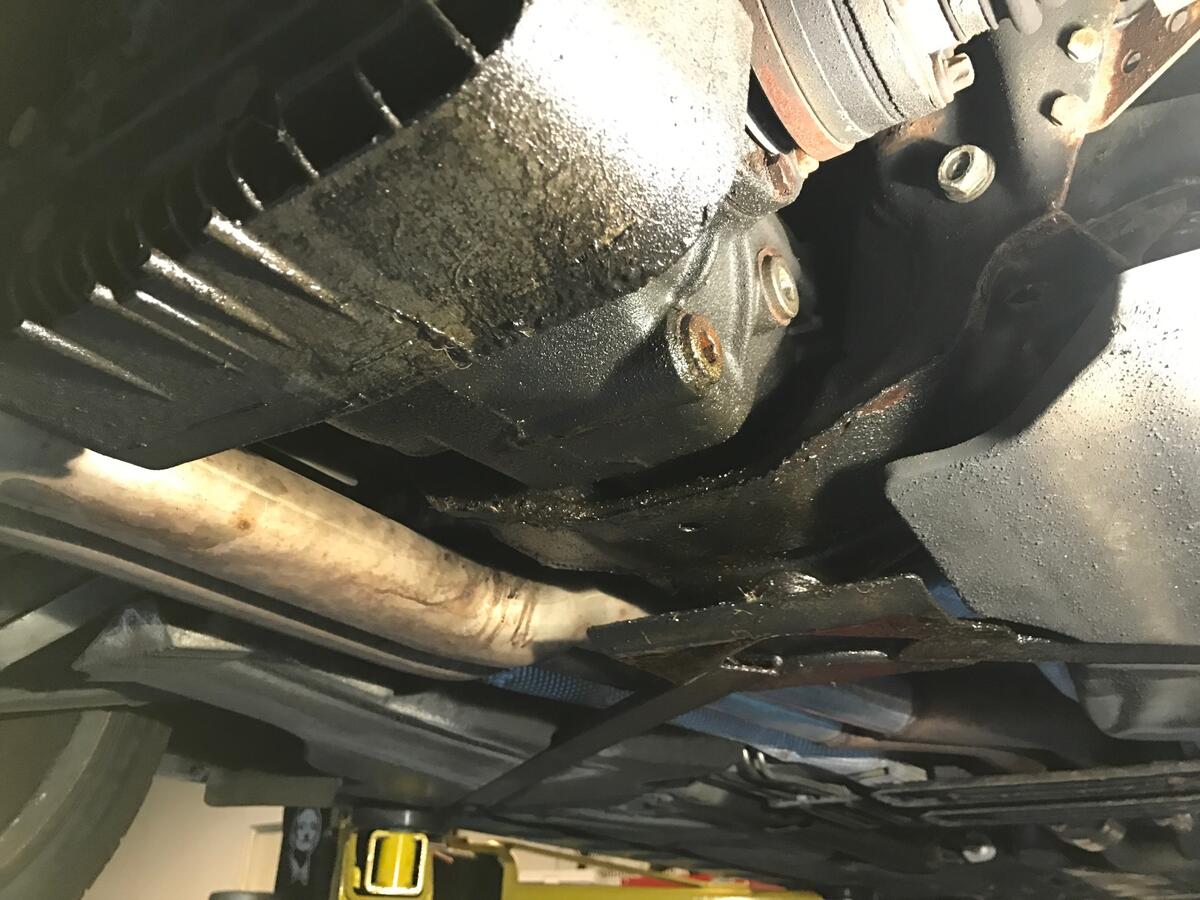

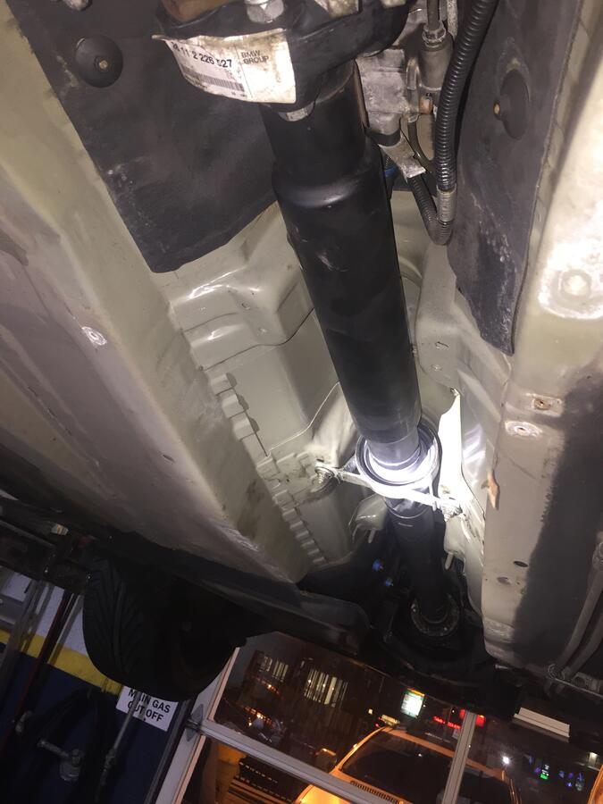

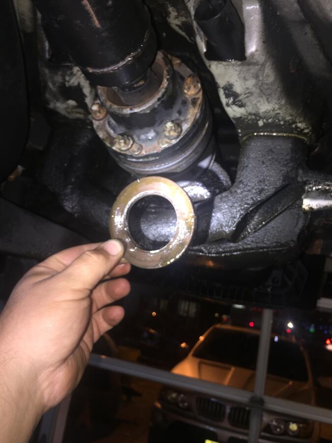

    Then I began with the inspection 2 and a couple other things at a local shop called Hybrid Motors. The previous owner told me that the differential was leaking so that was one of my main concerns. When I had to make sharp turns I would get a sound coming from the rear that sounded like rubbing against the fender so I was hoping we didn't have to change out the whole diff. The diff was leaking profusely due to the front pinion seal so that was replaced. Another issue the car has is the infamous M clunk. I was hoping that changing out the center support bearing and guibo would address that so i purchased those as well...
    The following was done:
    - Change diff fluid
    - Front pinion seal
    - Oil change
    - Change transmission fluid
    - Transmission mounts
    - Guibo
    - Center support bearing
    - Break fluid flush
    - Belts
    Luckily the diff leak was fixed but that was about it. Despite changing the diff fluid I still had the rubbing sound coming from the rear....I tried to do a bunch of figure 8's in an empty lot to work the new fluid into the diff but that didn't help. I read on the forum that using OEM fluid fixes the problem so I ordered some.
    My belts were shot so I had to change them but then it caused another problem... An annoying belt squeal!! On top of that I still had the M clunk from the rear when shifting and for some reason now I was getting another clanking sound coming from the transmission when shifting between 2nd & 3rd. I never noticed the issue when shifting between 2nd & 3rd until having this work done. Unfortunately I had only owned the car for like 2-3 weeks before this so I didn't have enough seat time to really notice I guess, but I think that's something that would've stood out before. Nevertheless something is off and hopefully it's not a synchro issue
    Click image for larger version  Name:	image_1205.jpg Views:	4 Size:	134.3 KB ID:	3580 Click image for larger version  Name:	image_1212.jpg Views:	4 Size:	90.5 KB ID:	3587 Click image for larger version  Name:	image_1214.jpg Views:	4 Size:	136.6 KB ID:	3588 Click image for larger version  Name:	image_1206.jpg Views:	4 Size:	56.8 KB ID:	3581

      - M clunk (most likely due to my shot diff bushings - see below)

      I arrive to pick up the car and to find out that the squeal is not gone because it was not do to the parts listed above, the alternator needs to be changed. The door issue wasn't fixed either, apparently the stealership missed diagnosed the issue and my module needs to be changed.
      But luckily after 5.5 hours of labor one of the problems was solved.... The diff noise is gone!! Apparently changing the fluid from redline to OEM did the trick and I no longer hear the noise when making sharp turns. One problem down and 98 more to go....

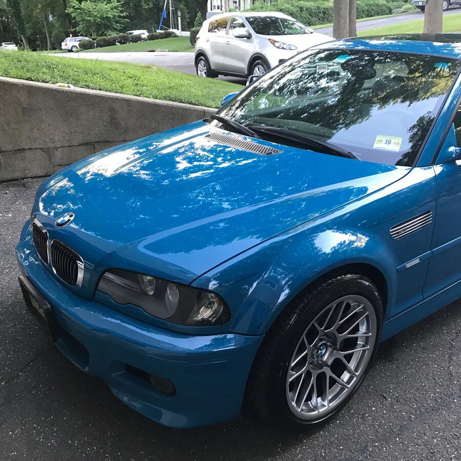

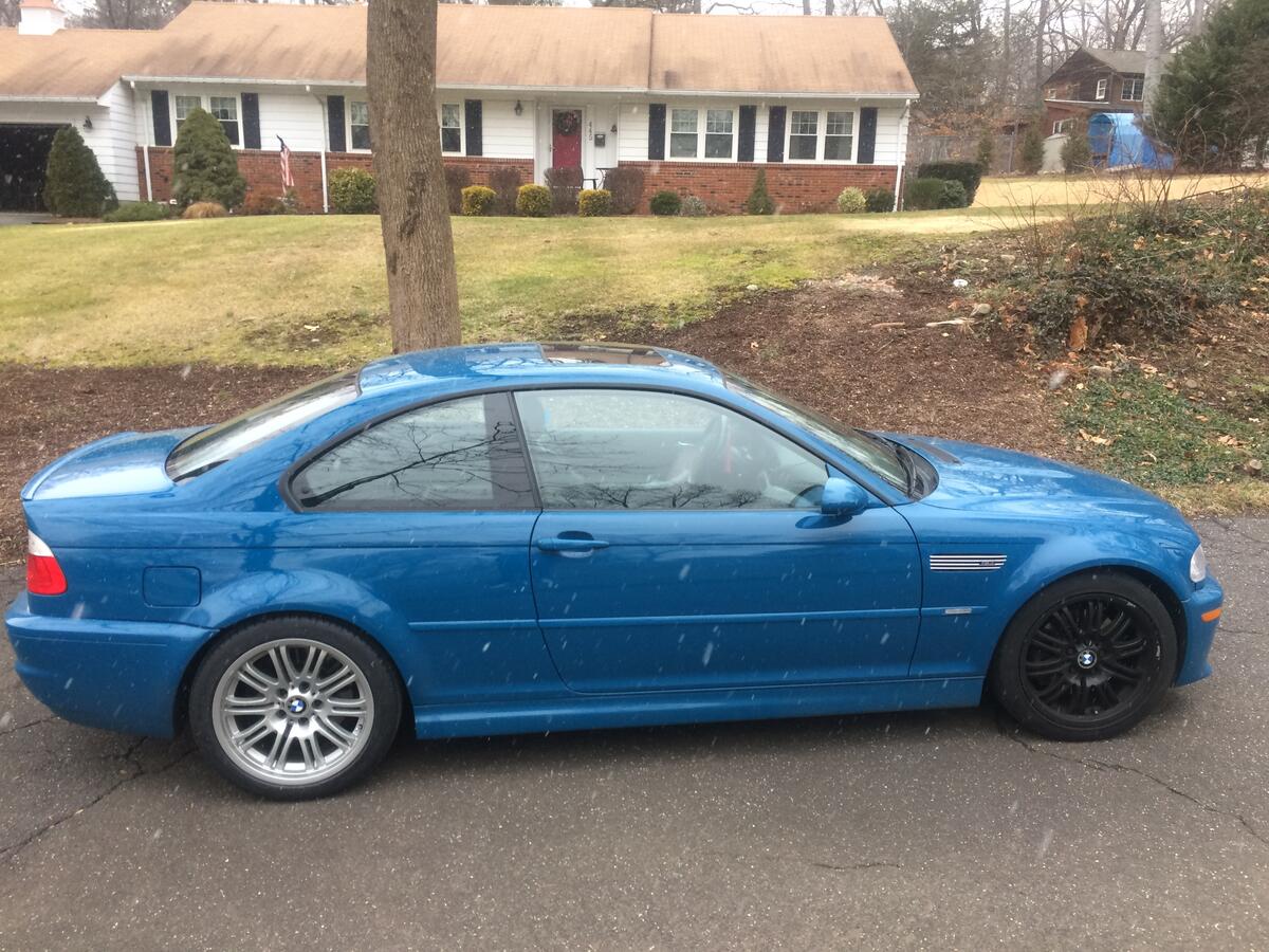

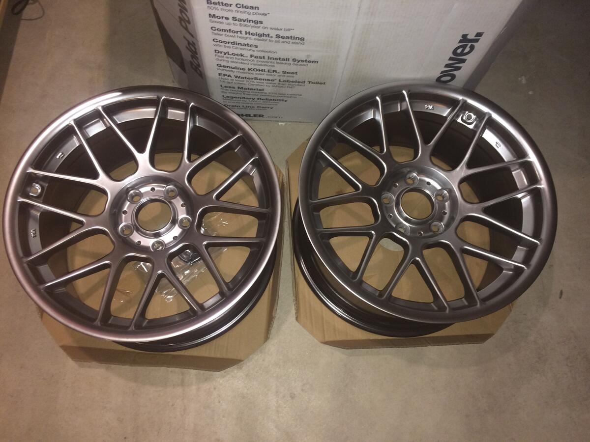

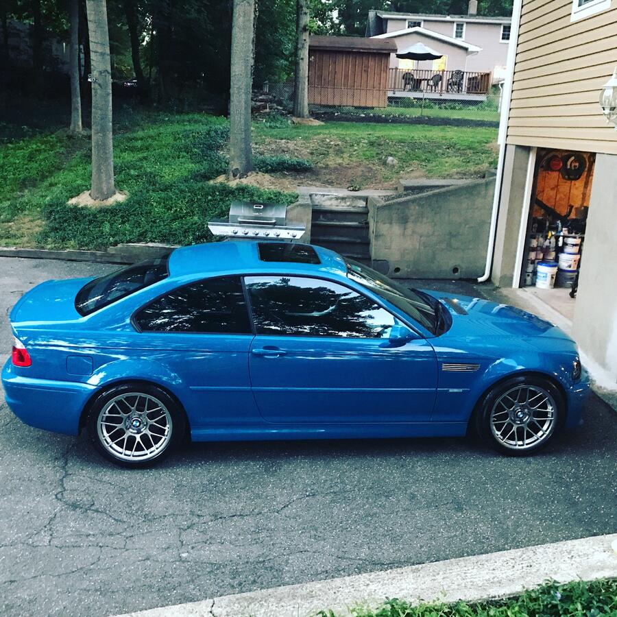

        Despite having a whole bunch of maintenance items to take care of I started taking care of a couple cosmetic things:
        - Apex Arc 8 (square setup) for the spring
        - Square OEM 18’s powder coated in silver on Michelin Pilot Alpines for the winter (hated the black plasti-dip look)
        - 72mm turner studs & 90mm in the rear
        - Kics Iconix R40 lug nuts
        - New side markers
        - Purchased painted reflectors and Vorsteiner CSL diffuser
        - Smoked Depo corner lenses
        - OEM LED tail lights
        - Black fog light cover (the gray one that came with the car was horrendous)
        Click image for larger version  Name:	image_1262.jpg Views:	4 Size:	215.3 KB ID:	3654 Click image for larger version  Name:	image_1261.jpg Views:	4 Size:	189.6 KB ID:	3653 Click image for larger version  Name:	image_1255.jpg Views:	4 Size:	129.1 KB ID:	3647
        Click image for larger version  Name:	image_1258.jpg Views:	4 Size:	140.7 KB ID:	3650 Click image for larger version  Name:	9AFAA847-5FA2-4CB4-B018-1F1C2B739473.jpeg Views:	0 Size:	126.1 KB ID:	3663 Click image for larger version  Name:	image_1257.jpg Views:	4 Size:	146.6 KB ID:	3649 Click image for larger version  Name:	image_1259.jpg Views:	4 Size:	180.2 KB ID:	3651 Click image for larger version  Name:	image_1260.jpg Views:	4 Size:	162.7 KB ID:	3652
          hi for the BS oil pump disk, did u replace both or just one? also, the 2nd to 3rd, will that be a syncro problem?
            I just replaced the BS oil pump disk because the hub was intact. It was definitely a synchro issue.... I’ll get to that later unfortunately lol

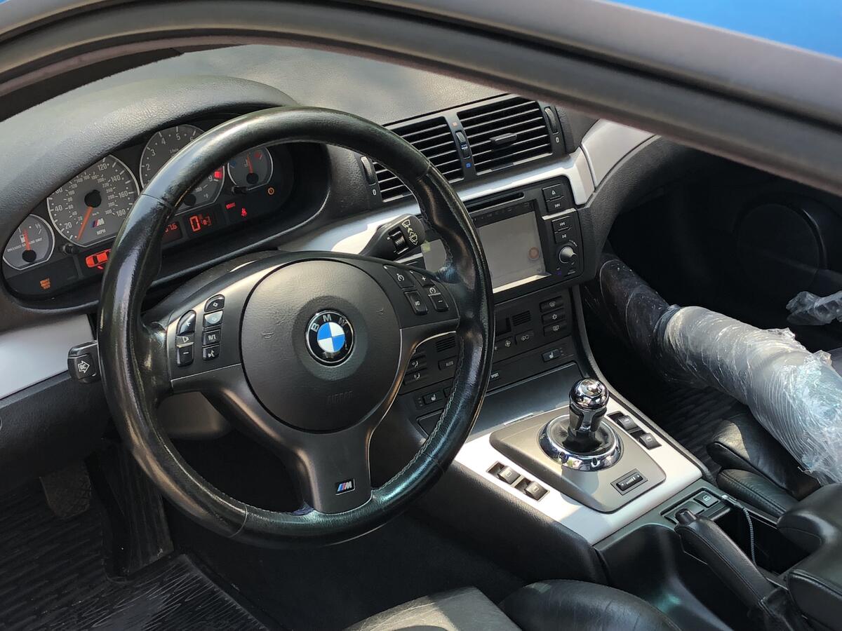

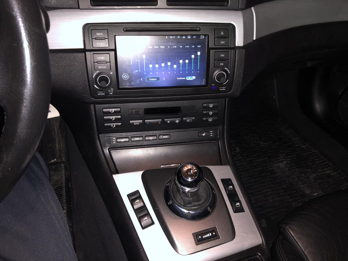

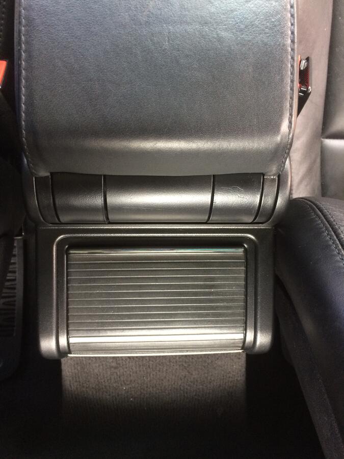

              I also did a couple things with the interior:
              - Upgraded the speakers to the Bav sound kit (totally worth the money)
              - Added the Xtron head unit
              - 20% tints all around

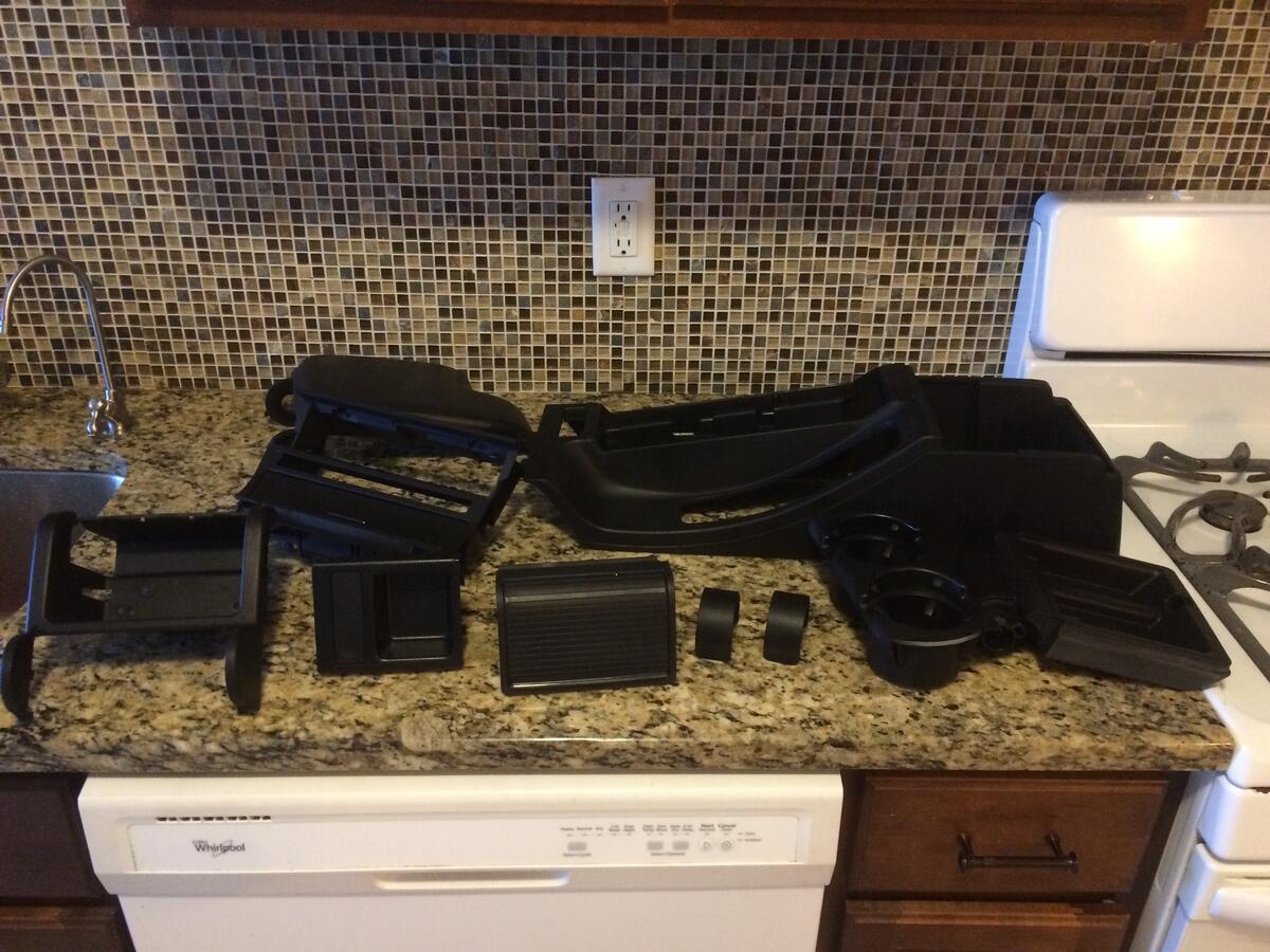

              - Painted the interior trim. It was a huge pain in the ass to do because of the material the trim is coated, but I love the way it came out. I could not stand looking at the scratched trim and I didn’t want to go OEM yet because I daily the car so it would end up getting scratched again anyway. Makes the interior look really clean and most people won’t know the difference anyway.
              Click image for larger version  Name:	38DDEEC4-0712-4A2E-B8D3-EDE09DEA8AB2.jpeg Views:	0 Size:	169.2 KB ID:	3681
              Click image for larger version  Name:	58848415-7441-4D7C-A919-D2C83F8A9A68.jpeg Views:	0 Size:	81.5 KB ID:	3688 Click image for larger version  Name:	image_1275.jpg Views:	4 Size:	78.1 KB ID:	3682 Click image for larger version  Name:	image_1279.jpg Views:	4 Size:	121.4 KB ID:	3686 Click image for larger version  Name:	image_1277.jpg Views:	4 Size:	141.8 KB ID:	3684 Click image for larger version  Name:	image_1280.jpg Views:	4 Size:	173.7 KB ID:	3687 Click image for larger version  Name:	image_1278.jpg Views:	4 Size:	146.4 KB ID:	3685
