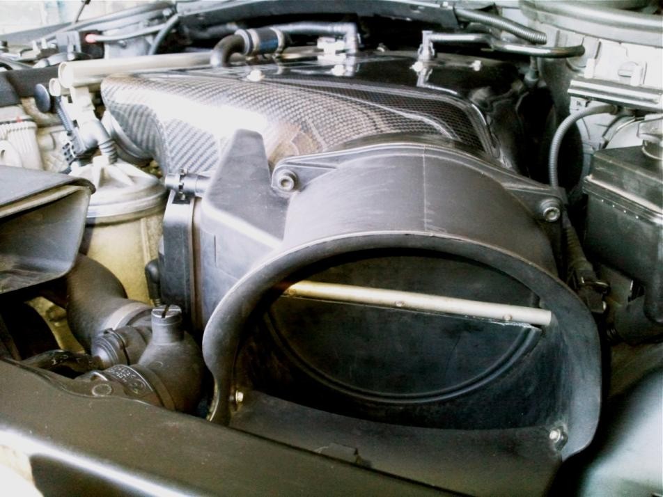

    Sorry guys another flap question.Seen a lot of posts about taking the flap off the induction box,but can someone give me any idea how to put one back on,do you have to take the box apart and all that.:smt100
    Yep... U have to take the strut brace off first and then the front half of the CF Air box as the three little bolts screw on from inside of the Air box /the back of the flap. Easy DIY job but be very careful not to scratch the CF box half or loose any bolts inside the engine bay :clown: . Good luck :thumbs:
      You don't need to remove either strut brace or CF airbox. Just disconnect the electrical connectors (x3) before manually turning the flap mounting bar to expose the 3 x bolt receptacles. You just need to ensure that you return the bar/flap back to the closed position before re-connecting the electrics - thus not confusing the actuator.

        Thanks Rob,just incase i need to put it back on,one of the service guys at bmw says if i ever have any trouble with the engine i may not be coverd under warranty as i have modified it by taking the flap off,and i may need to put it back on in a hurry.:whistle:

              On a more serious note, I originally tried to turn the rod manually with all electrics disconnected and it wasn't as easy as U describe, as there isn't much to grip onto. I thought of putting a small flat screwdriver in the slit where the flap goes but thought ... better not... as I didn't want to brake anything, this being my first DIY fiddle with my CSL. The way I did the job was safe, didn't require any unnecessary force and was quite a bit of fun taking things apart for an up close inspection. I also understand why the air-box is soooooo expensive now :whistle:
                Thanks for your advice Matt,if i cant get it to turn with ease i will try it your way.
