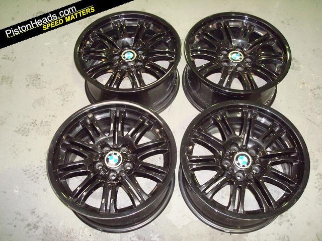

I've just bought a set of 4 Genuine BMW M3 18" 9J rears from your mate Mike in Essex to use as my Track wheels. They've been refurbed not too long ago in dark Anthracite and look V. COOL :thumbs:
My question is, what tyre size should I be considering for these... standard size of road tyres is 255/40/18 but they're not available in Track Day tyres sizes so my choice is either 255/35/18 or 265/35/18 (like the ones you're planing to get) Have U checked if fitting 9J 18" with 265/35/18 tyres poses any issues at the front :whistle: ... rubbing on the front wing on full lock ??? or getting too close to the suspension strut maybe ??? I'm running standard brake callipers, standard rebuild suspension and no spacers.

The off set of the BMW M3 18" 9J rears that I have is ET26 and the tyres I'm considering are: TOYO R888 265/35/18 @ £912 all in delivered (not fitted)... TOYO R1R 265/35/18 @ £ 868 all in delivered (not fitted)... or Dunlop DZ03G 265/35/18 @ £1100 (auch!) all in delivered (not fitted). Yokohama A048 in the same size are a whopping £1488 !!! not fitted . To be honest none of these deals are as good a deal that you have with your local tyre place of £800 for the same size set of Cups. Just to double check with U, is that £800 inc. VAT delivery & fitting for 4 X Michelin Pilot CUP 265/35/18 s ? Same tyres as recommended for the M3 CSL, just one wheel size smaller ?Originally posted by shimmy View PostCups come in 265/35/18 like the ones i have ordered. You may find other sizes in Yokos, Toyo T888 and Dunloip Direzas to better wuit the 9J but 265 should be ok as it is within tollerance.

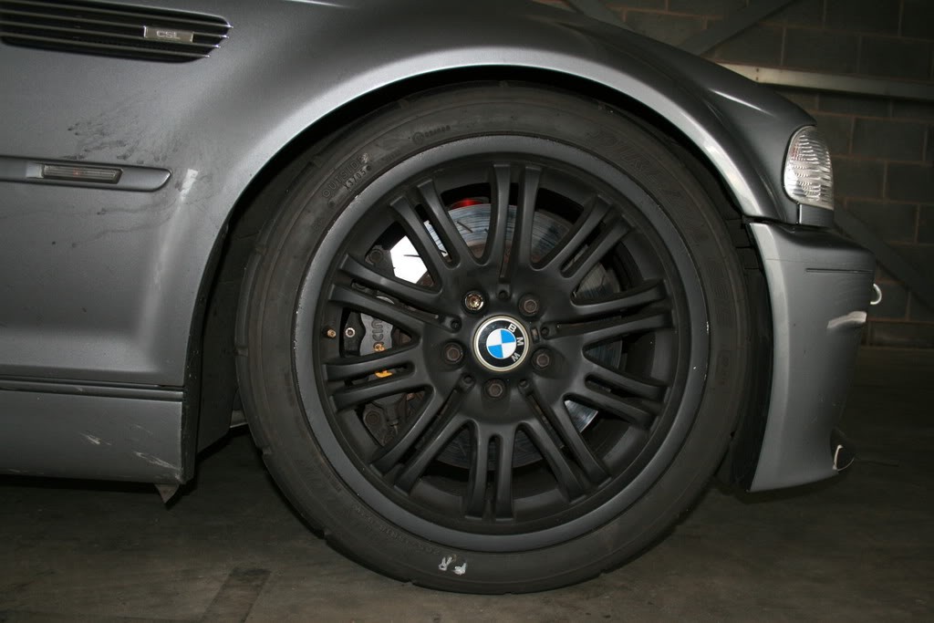

BTW, I found a pix of someone on here who run this set up with Dunlop DZ02Gs in 265/35/18, although I see from the pix this CSL has aftermarket suspension and probably runs RACE cambers + the obvious AP racing anchors, which seem to clear the 18" 9J rears OK :thumbs:

It was indeed. Intrax suspension and APs alround meant that the DZ02 were excellent. Dropped the pressures to 25 psi so they rose to 33 psi hot giving no understeer and excellent stability under brakes (left them on least camber with the adj top mounts, so guessing -1.5 degrees?) They were rear M3 rims alround but Hazy has them now! Going with cups for the few trackdays I get to do!
