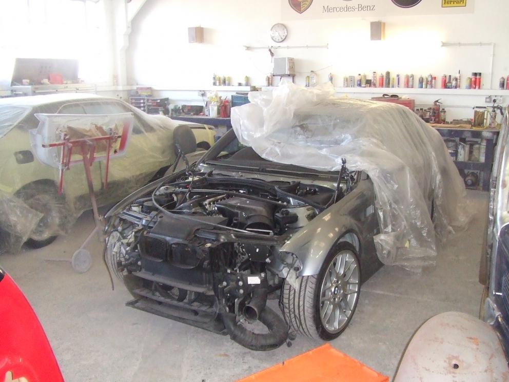

    Thought i would post a couple of the CSL in the paint shop for a freshen up.

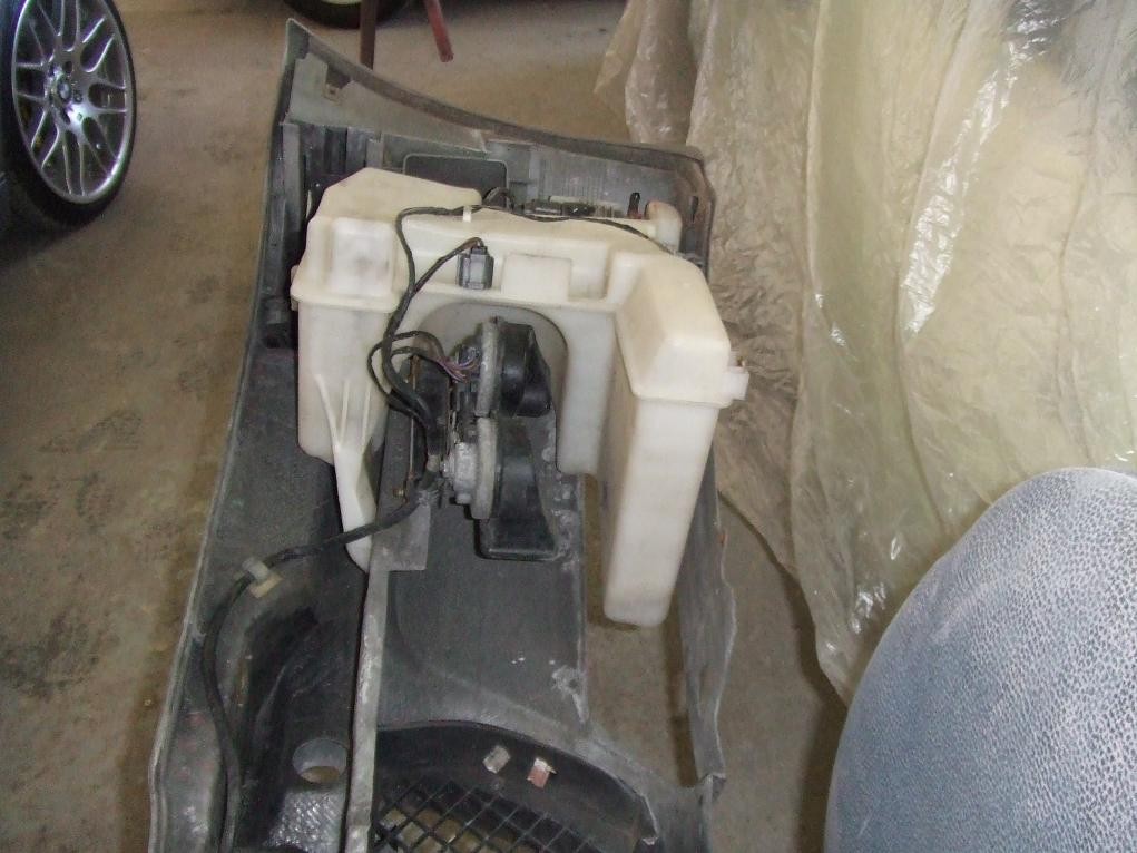

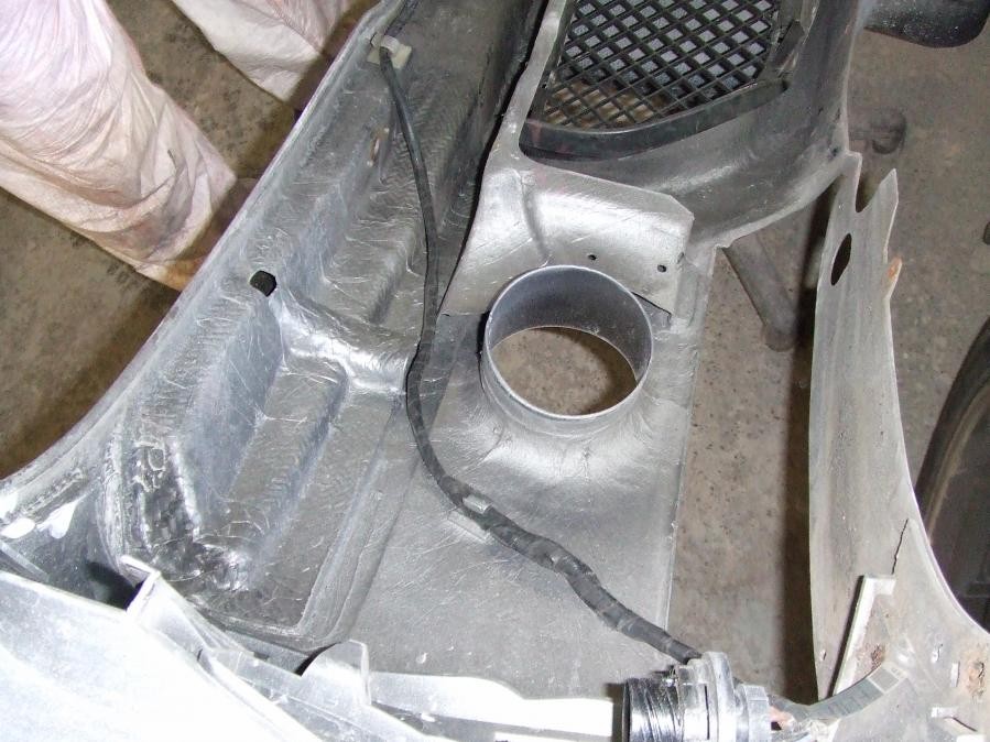

    My painters had about 6 CSL's in before and he reckons my bumper is not OEM.................(or it is but an earlier version)
    It fits perfectly and i would not have thought it was not the real deal
    What do you guys think? :whistle::thumbs:

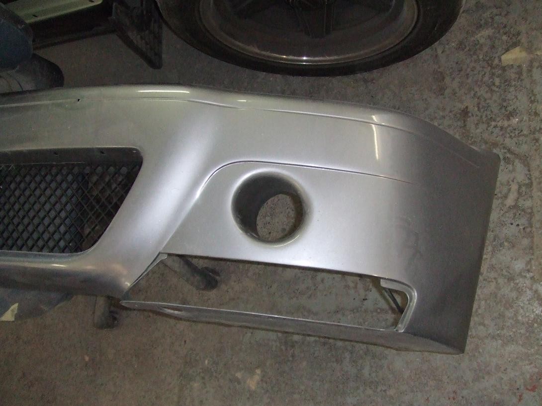

      This is pre paint, he reckons the curved bit around the air intake & the other side is not as carved as they have seen, and the top indented line around the front is a little shallower than on others?
        thats a genuine bumper

              Looks genuine, the line might be shallower as the people who painted it before didnt sand it down properly and is thus filled with more paint residue then it should be.
                Funny you should say that, i spoke to the painter today and he was scratchin the bumper back & he reckoned it had about 6 paint over paints on it............That must account for some loss of profile:bigcry:

                      Your painter's on drugs ... if that isn't a genuine bumper then it's the best replica there is.
                      There is only one replica CSL bumper out there with a built in crash bar ... but that bumper's made of fiberglass not Carbon Fiber, and I've only ever seen one of those on ebay a while ago.
                      99% of all the other CSL replica bumpers out there have no built in crash bar - it either uses the aluminium carrier method or the separate kevlar bar mounting method.
                        Compare these pics if it helps:-
                          Safe to say shes the real Mcoy then!.........cheers fellas:thumbs:
