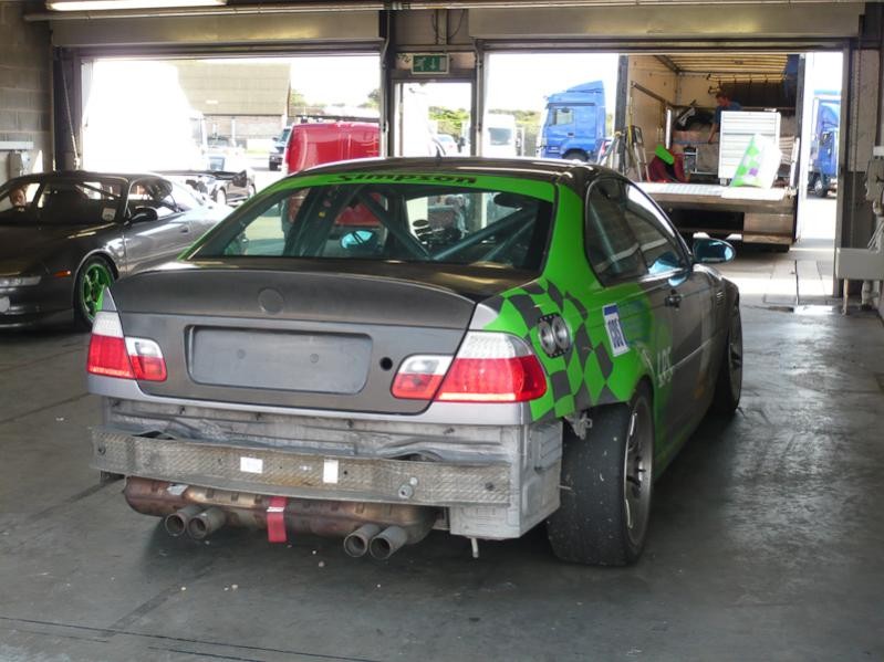

    Hit the tyre wall at Oulton.
    Worked a treat on my front one :bigcry::bigcry::bigcry:
      lol Hazy - I normally find that careering backwards through the old hairpin gravel trap does the job:
        :hahaha::hahaha::hahaha:

            I find it easiest to remove the kevlar impact bar with it - so pop open the plastic panel inside the boot and you'll see 3 nuts that hold each side of the kevlar impact bar up - undo those and slide the bumper off after unclipping the side and undoing a couple of 8mm screws.
            Not hard to do it this way and saves messing with the diffuser and breaking clips on it ect ect ...
