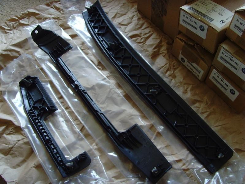

    you can just pull them off with your fingers. in the picture you can make out where the clips are (metal bits, sticking out).
    if you need to use a flat screwdriver to lift the edge away make sure the end is covered with a tea towel or something equivalent so you dont mark the trim.

        Daz, I got a set of plastic trim removal tools for just that, if you want me to check in the garage to confirm I still have them then you are welcome to pop round and borrow them. You start from the passenger door side and work your way along.

          a plastic icing sugar spatula and gently pull off

                      Basically a bunch of plastic crowbars with different shapes to allow you to lever stuff out without scratching things.
