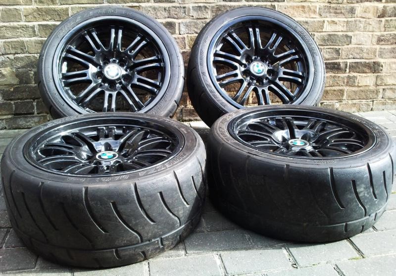

    Has any one used these tyres on a Trackday
    And if so how do they compare with the cups ?
    I have heard they go off quickly and are noisy !

    I have used 888 many times, csl probably too heavy to get the best out of them.
    I had a set of 265 to go on 9" rims, but they were far too wide, they are huge compared to cups, a048, dzo3g of the same size.
    They are a decent tyre but go off after about 3 hard laps, perfect tyre for sprinting, not so for hard prolonged track. That said, they are pressure critical, get pressure perfect and they are great.
    I imagine they would be great for the ring though, thats what I bought mine for,
    PS I get good discount on the 888's if you need a price:thumbs:

        I've just bought a set of these and fitted them to some OEM 18's.
        I've not used track tyres before, so am looking forward to seeing how they perform.
        I'm guessing you've used them a bit? How many days do you get out of them?
          Road noise is shockingly loud
          they will go off quicker than Cups.
          I'd try the Dunlops or Kumho first or if budget allows buy Corsa Race tyres (not corsa system)
