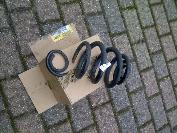

    Just got a quote from Broadoak for the ball joint - £360 all in - and the springs are £101 each so I will probably just buy a pair and get a mate to fit them.
    Cheers,
    Phil
      Replaced both springs today - fairly easy job as long as you have 2 jacks and a mate (Dad ) who can help push the arm down to get them out and back in.
