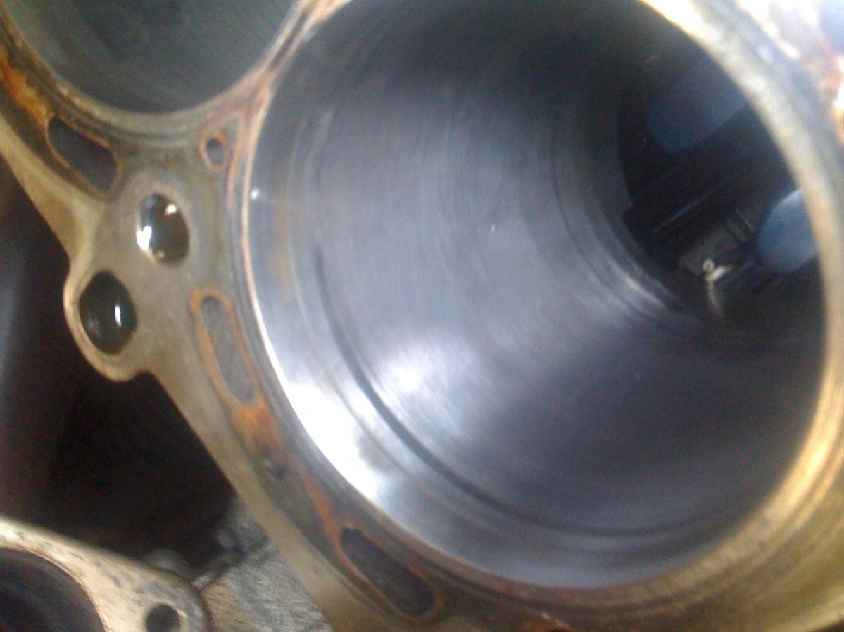

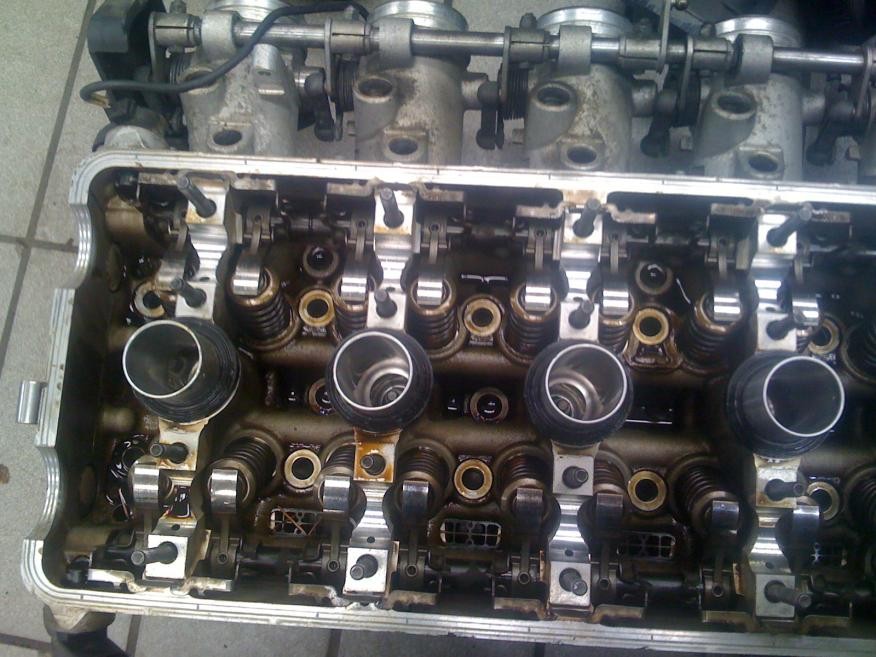

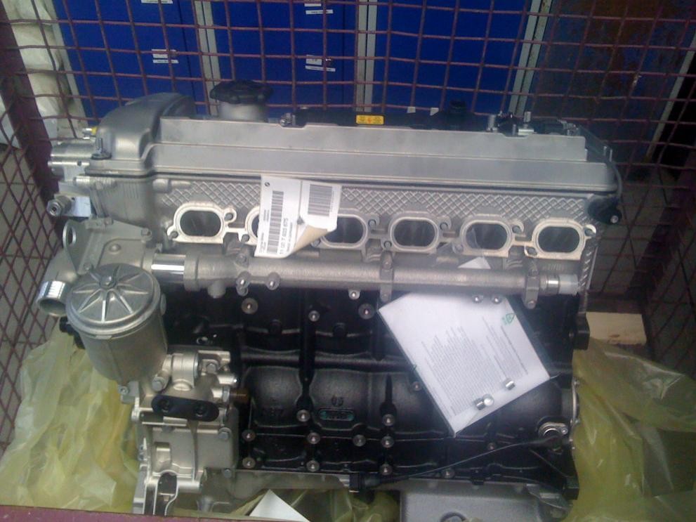

                Sounds like it did the same to mine i got a new engine after the head was removed as the bores were damaged at the top :bigcry:
                Pic 1 The cam followers were like 50ps
                Pic 2 The the markes on the bores
                Pic 3 The new lump waiting to get fitted :notworthy:
                  Mark,
                  Thanks for sharing, and yikes!
                  I am really hoping that the damage on mine isn't as bad, but oil starvation seems to be a common issue from what I've read on here. Seriously hope it doesn't need a new engine, as I'll need to run it in before going to the 'ring and that will require me doing crazy things like allowing the missus to drive it to work, etc. Fingers crossed.
