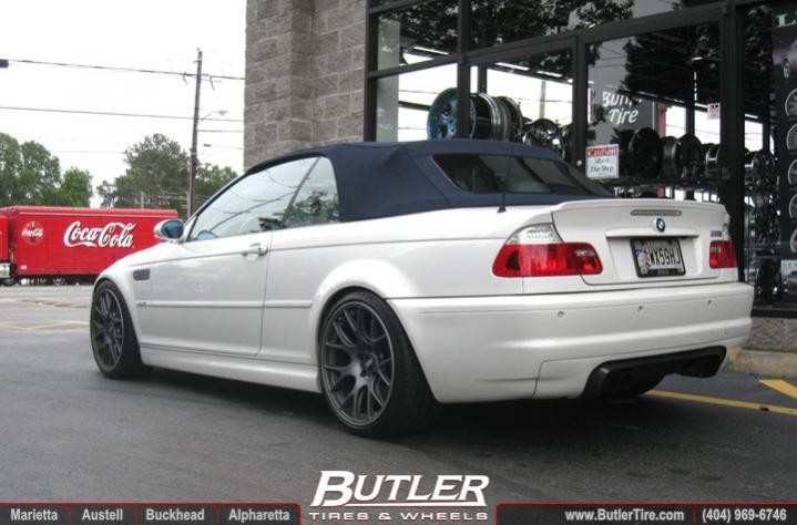

    Founds some pics...
    "Here are the details for this setup:
    19x8.5 ET 35 Front with 245/35/19 Tires
    19x10.5 ET 27 Rear with 275/30/19 Tires
    As far as rub - there is none! And are they uncomfortable? Well there are a whole bunch of variables that would have to be discussed in order to come up with a conclusion on that point but generally from what we have heard and because of our hi-speed on-the-car wheel balancing it rides smooth and comfortable."
      There is no doubt that's a good looking wheel :supz: but I'm not a fan of that EURO stretch look of the rear tyres :banghead:
      IMHO 10.5 J may be just too much for the E46 M3 rear.

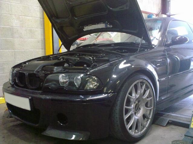

        I used those wheels on my CSL. they needed spacers on the front. 10mm if i remember.
        There are pictures on here somewhere check my profile out or search threads started by me.
        What did surprise me was the BBS wheels were heavier than the standard CSL wheels.
          I had them fitted with KW clubsports
            Just seen that these are CH-R
            Sorry i used CH

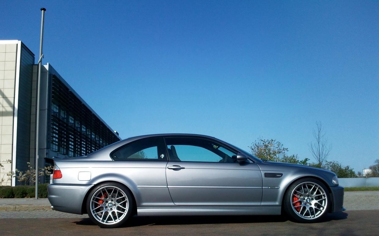

                      Who's is this - perhaps we should ask him what he's using (pictured at Darren Wood in Stockport)
