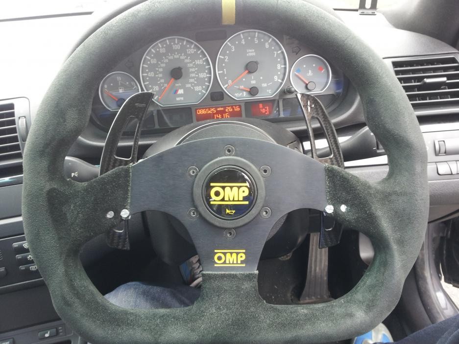

    Finally got around to installing the SMG Paddles onto the OMP wheel.....work perfectly...just need to find some black bolts now.....:supz:
    Good effort but I prefer the standard wheel. How have you fasteded the electronics for the paddles?
              I removed the existing swithches and wiring from a standard wheel and the fed the wiring through the boss kit and into the standard plugs on the steering wheel ring.....no wire cutting or butchering required....I used m3 nuts and bolts to secure it to the OMP wheel and used one m4 nut per side as a spacer to put between the switch and the back of the wheel to get the right fit....this will be different depending on what wheel you have etc....
