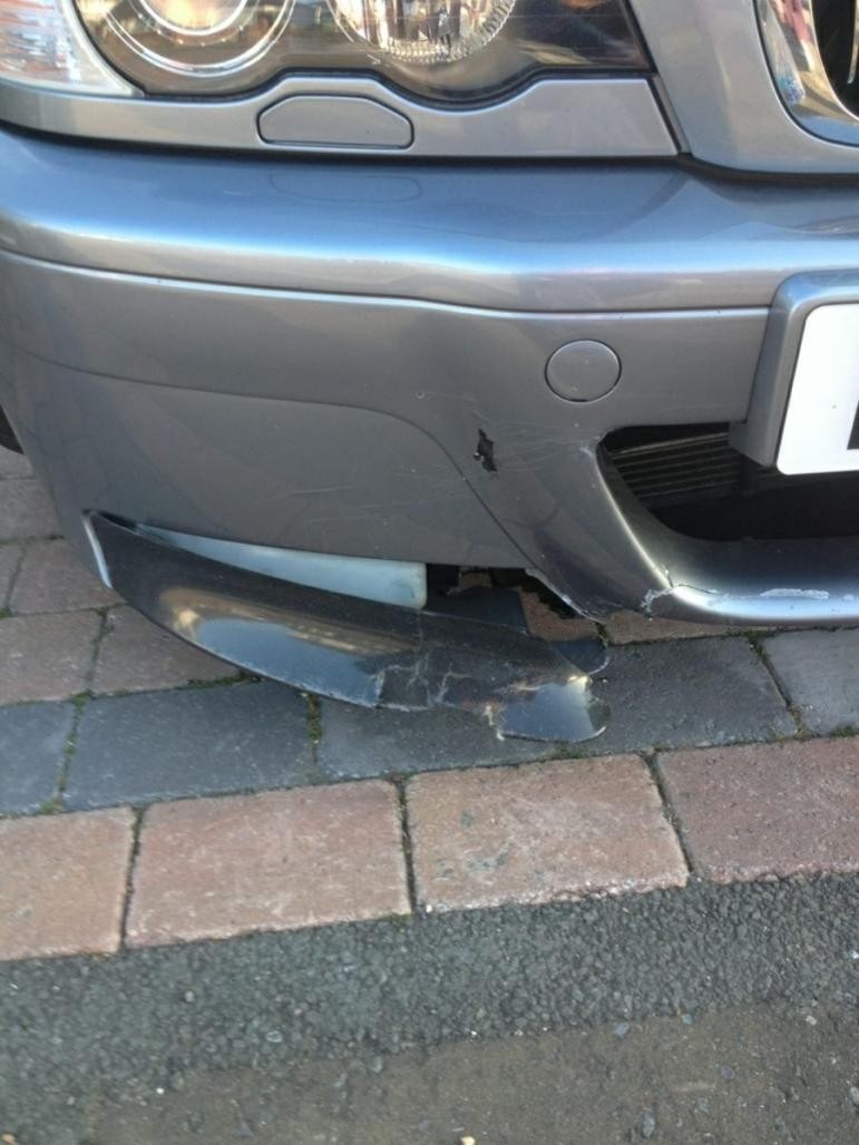

    Hi chaps,
    Recently had a run in with what I think was a hare .And have cracked my bumper ,splitter ,plastic under tray and bottom part of radiator .:bigcry: Some of my part names may not be quite right (sorry) .Does any of you guys know if these parts are easily sourced or even repaired (especially bumper)or should I just see if my insurance would cover it ? Any advice would be really appreciated .
    Both parts look easily repairable - especially the bumper, that's bugger all damage.
    The splitter will be a little harder and won't look the same, but usable.
    Plastic trays and arch liners are easily sourced.
    If covered by insurance get a new bumper and splitter, but keep the damaged one and repair it. The brilliance of Carbon Fibre is that it is easily repairable.

                      Thanks for the advice ,looked into Simpsons and its 160miles so courier for the bumper maybe the only way forward as the car is only limping at the moment and may not last that distance .Does any of you guys know where I can get the other parts from ? Thanks for your offer in sending Karbonkid ,I might get bumper off tomoz and speak to Simpsons Tuesday ready for posting to them .Do you have sg csl with black wheels as I spotted one on the A3 on Saturday ?

                        New bumper £2700 if I remember correctly.
                          That's definitely repairable...
                          I've now had two csl bumpers repaired. Both were in way worse condition then yours. This last time when i had a girl side swipe me, my insurance coughed up for a new one for me. So i actually lucked out with my insurance, and i don't even own a real csl. The only thing my insurance made me get was additional coverage for future events at list prices of all the oem csl parts i have on my car. If you go through insurance, don't throw out your old bumper as it can be easily repaired. The damaged bumper could still fetch over 2,000 usd. I personally will be listing a reparied oem csl bumper for sale in the next month, as its at the body shop getting patched up. My asking price will be 2,600 usd for the bumper with splitters, asa bolts, brackets, and washer bottle. So good luck with your repair, or purchase of a new one.
                          List price of new bumper last i checked which was two months ago now was £3781.00 gbp
