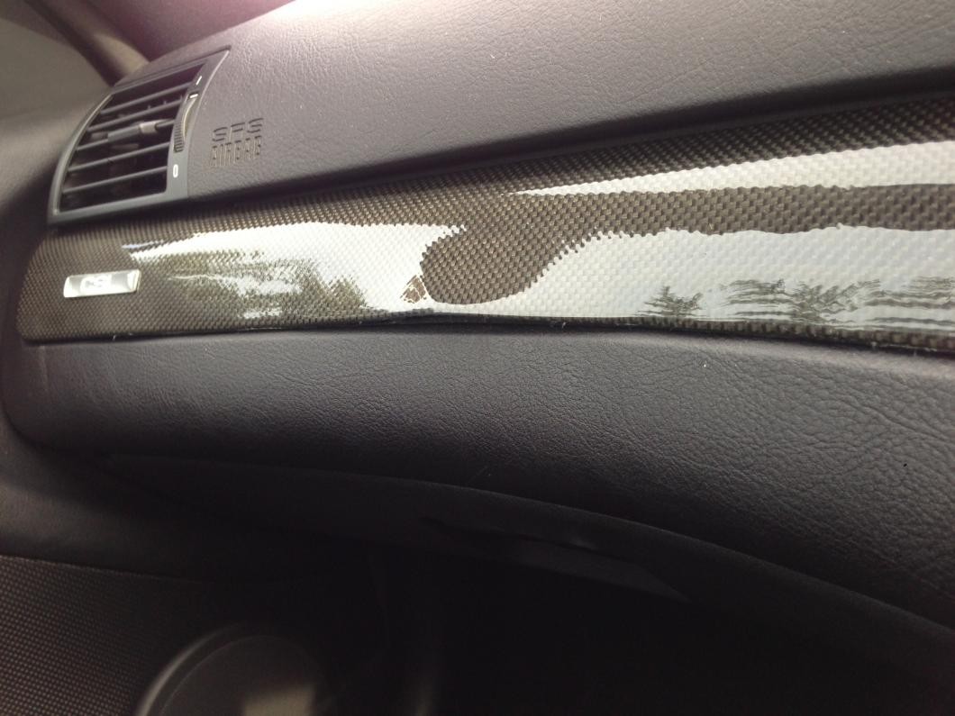

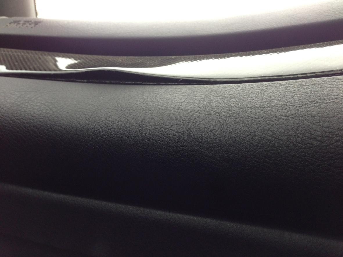

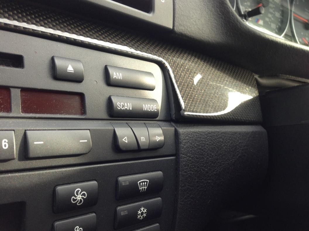

    I guess this London heat does have its disadvantages; first a piece of my roof liner came off and now I see that the carbon parts added to the interior of the car have started to warp! :bigcry: See pictures below.
    I'm not sure if there is an easy fix to this other than buying a new set...Perhaps a heat gun and some bonding glue? Suggestions?

      My pax dash insert did the same...Mark to the rescue!
      Sent to Scotland and back inside the week.....not sure of the method but finish was as new.:-D
        If you got them from me post them back and i shall sort them.
        It looks like the carbon has not bonded properly it will need removed and done again.

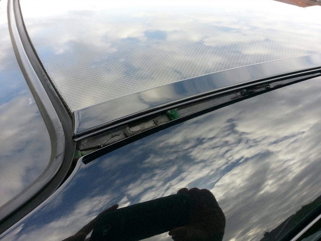

                    Attached is a picture of my roof liner issue.

                        First i glue it back, But after a few days the glue let loosen.

                          £180 was IMHO a tad pricey. But there was a lot of flex in the rails, enough to lift 40cm of gaffer tape.
                          The glue I'd previously tried lifted and they quoted me £600 fior two new rails,including paint.
                          My liftt was quite noticeable
                            The clips are bonded on when the roof is installed with resin
                            You can get the wurth sealer they use for the sump gaskets to stick the trims back down.

                              I've had 3 E46 M3s (one of them my current CSL) and all 3 of them have had this problem with the window seals. Elms glued them once for a very cheap price (just £50 labour, I think) but ultimately they came loose again. The fix I used is to buy some strong rubber bonding glue and some small fixing clamps, glue them up, clamp them and leave them overnight. Never came loose again.
