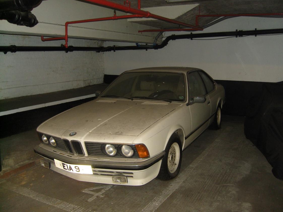

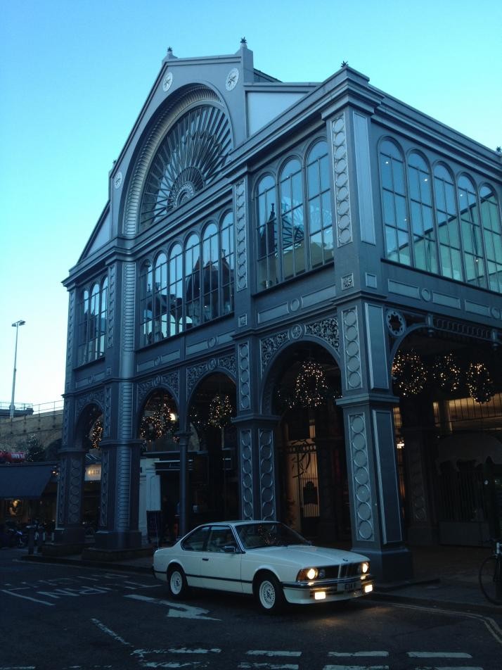

    i thought i would give you a bit of an update in my 1979 E24 to managed to rescue from the under ground garage of a building in the west end.
    my friend works for the building management company and he informed me that there was an old BMW that had been there for years the owner had died some time ago and it belonged to a rich family from the middle east who were not interested in it.
    i went down a took a look an to my amazement it was a 635 csi a car i had always wanted ! the management company told me if i could get it out i could have it !!!!
    i got a mobile key cutter down there so i could get in and connected up a battery and she came to life, everything worked
    lights , windows, sunroof, elec arial, i could not believe it

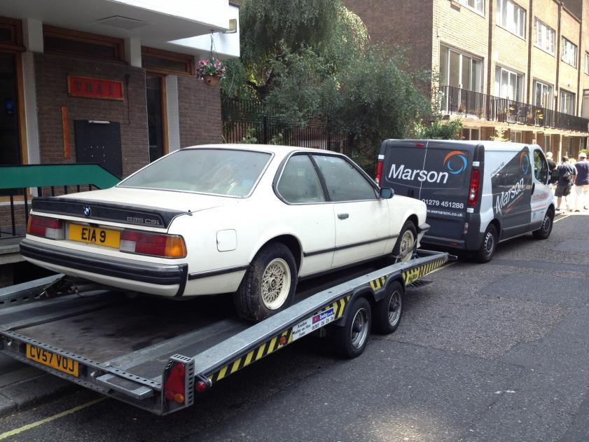

    i dragged it out with my van bear in mind the last tax disc was 1995 so the brakes were all seized up.
    i got it back to my work shop and started to tinker, freed all the brakes up (4 pots on the front) new pads and discs all round, drained the tank and swapped out a 12" length of rubber fuel line that had gone hard turned the key and boom started with out a splutter.
    at this point i thought i would find the family and buy it from them as i did not want to fix it up and then they come and take it back, so i managed to get in contact with them and bought it from them and obtained the V5.
    the fact it had been in an underground garage for 20 years kept at the same temp all the rubbers and hoses are in perfect condition so none of them needed changing.
    then the fun started, due to the fact she has sat for such a long time all the coolant had evaporated and crystallised like rocks in the coolant system and she had a bad habit of over heating and doing a massive brown piss on my drive way, i had to strip it down as much as possible and clear out these rocks of old coolant.
    i must have flushed the system 10 times with all different types of acid in it but after all that and a new water pump she never over heats and goes like stink.

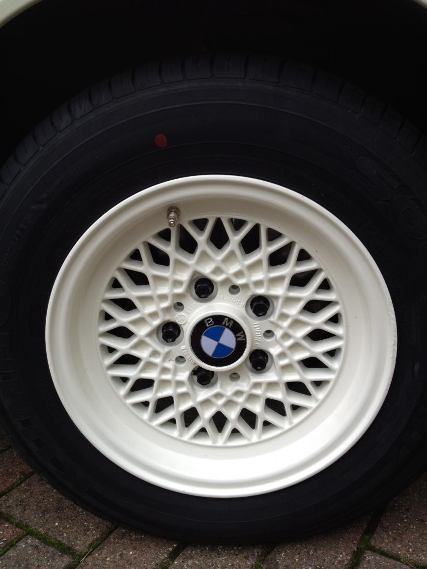

    a dam good clean and a wheel refurb and i think it is one of the best looking cars around, every time i take it out people stop and ask me all about it as its such a rare beast.
    i love the fact the whole dash is in german and it was an early model so it has not got all the big body kits on it ect ect
    for a 1979 car its got some kit as well elec windows, power steering , elec heated wing mirrors, elec sun roof , dog leg manual gearbox , LSD and seats that are better than my front rooms.
    18k on the clock and drives like a dream i could not be happier !

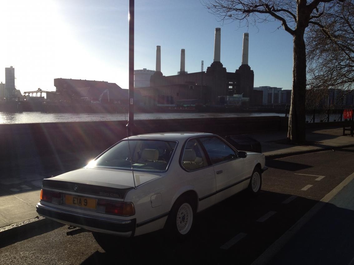

              Plate is a N.Ireland plate so perhaps the previous owner or indeed the car spent a time over here ?

                  Did the plate come with it also ?
                    Thanks for the comments gents,
                    Yes the plate was on the car and had it valued at more than I paid for the whole lot, but to be honest the value of the car it irrelevant.

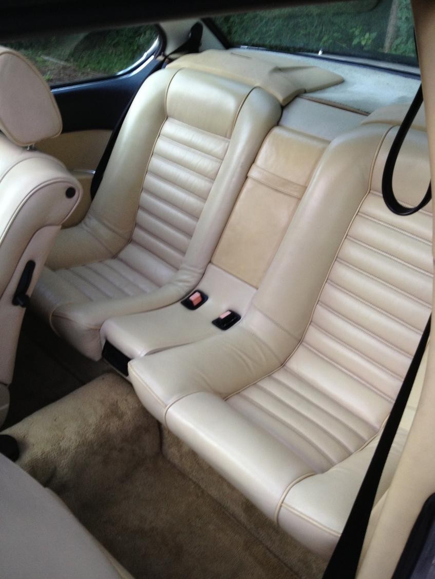

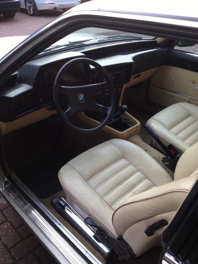

                        How about some interior shots ?
                          i think the car originally came from Yemen as the family were from there but no more info other than that it was imported in 1980,
                          when i got the car it had a graphic equaliser screwed into the dash behind the gear lever, when i drove about at night it was like having kit from night rider trying to give me a BJ so it had to go, but it left some holes to im going to get it repaired
