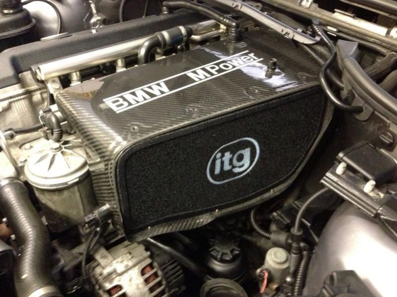

    Originally posted by Mike R View Post
    The fact that the ITG logo is sprayed on upside down REALLY annoys me :moan: :hahaha:.
    Just for you Mike:
    Although you can't see it with it's snorkel on!:thumbs:
      is it one of those fake ones?
