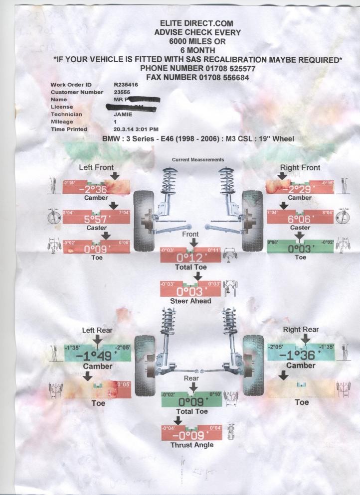

              Well after a few problems with communication I declined the kind offer from Adem and just got a secondary geometry check. Attached are the results. Aplogies the paper got wet and had to be dried by me and has caused the ink to run on the OEM parameters and toe readings.
              From talking to the chap there he seemed to think the settings were good and was just suggesting the toe could be slightly adjusted (rear readings have washed out of the paperwork) and front caster could be improved.
              For the track gods and twerkers (not Miley C) what is the consensus/opinions - ?

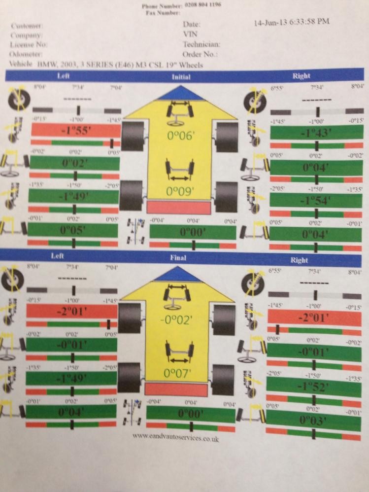

                This is close to what it should be!!
                Your rear toe is too far left setting thrust angle to the left!!on rear axle
                Front left toe is too far in(cause of tyre wear)
                Steer ahead is too far right and the castors aren't close enough!!
                This pic shows a relatively basic setting on my csl apart from a bit extra camber due to not having top mounts and the ride as low as possible.ive now got top mounts and will post another geo once i get my shock back from kw.

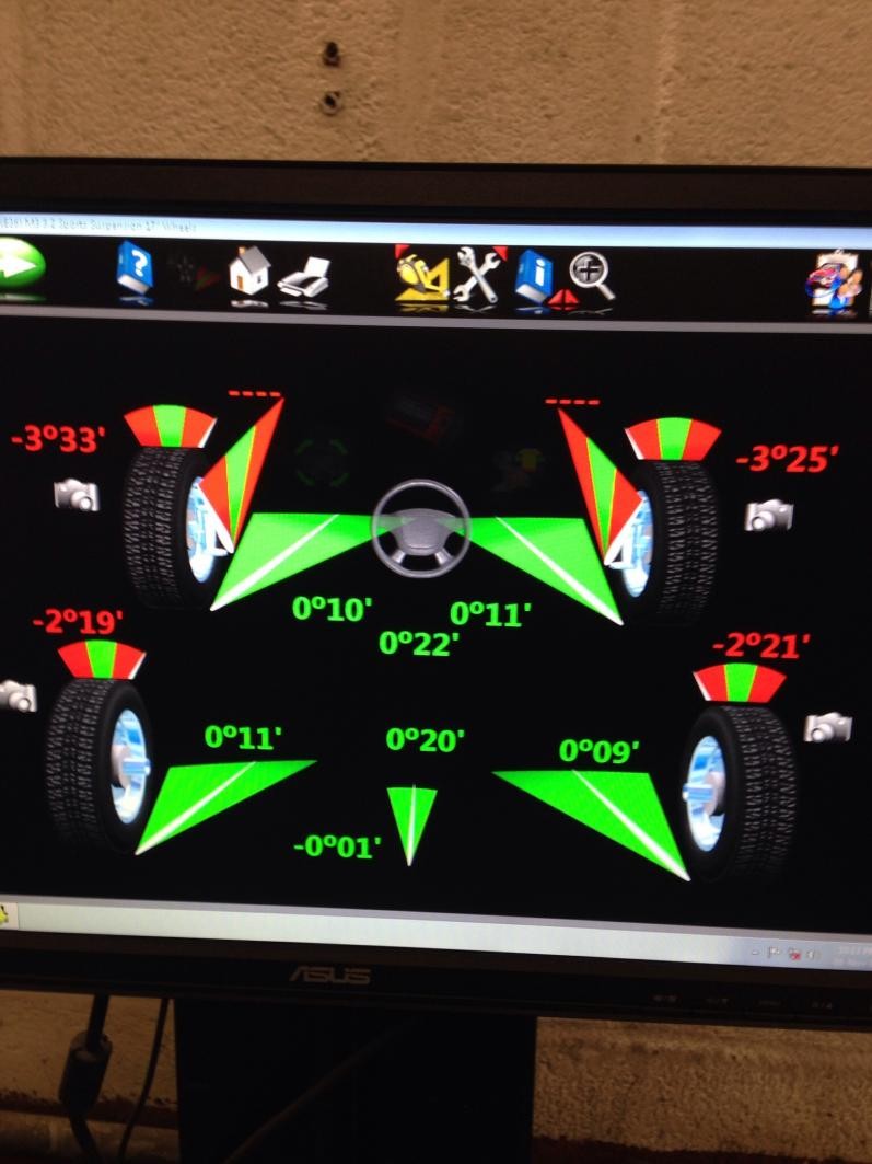

                  This is my vert again clean settings except camber and we do a minute lap round brands!!proven[
                    Looks a good bit of kit, will arrange with you to get mine down next month :thumbs:
                      The first image is a print off the second(more colourful)is actual live data as i track the car i can set is as much or little as you like and its so precise its unreal
                      5k i think this machine set us back so it gets regular updates and calibrations
