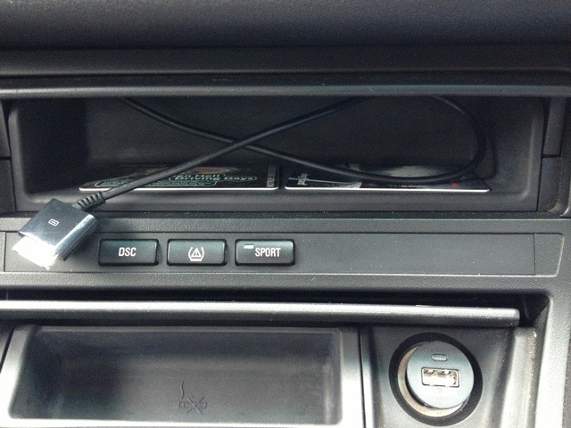

        Q - Is there an allowance for a 3.5mm stereo jack for iPod connectivity or any outputs in the back of the stereo?
        No factory 3.5 mm AUX but you can buy a cable that plugs into the back of the Business CD where a 6 CD changer connector usually plugs into on a regular E46 M3. I have one on mine and it work a treat. eBay has some options :thumbs:

          I'll be happy with some kind of RCA outputs on the back of the CD player. Obviously not keen on drilling and holes or removing the factory unit.

                As for the iPhone/iPod connectivity, the plug-in cable option is as simple to instal as it sounds without the need to drill anything and totally reversible :thumbs: Since the CSL does not have a CD multi changer in the boot, the OE "Business CD" unit has a free space for the before mentioned plug in iPhone cable. This will allow you to play your tunes trough the AUX mode on the OE head unit. Here's a pic of mine which I fed from the back of the OE head unit into the upper centre console storage compartment where I keep it when not in use. :thumbs:
