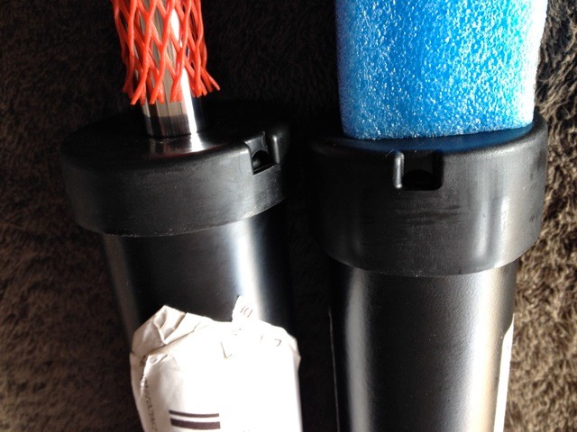

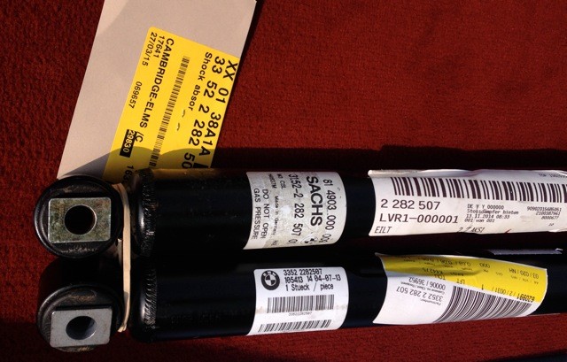

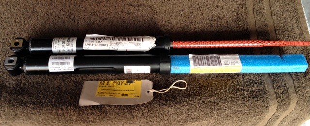

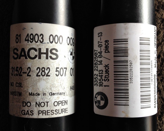

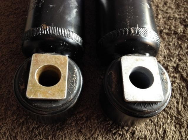

        Good to know we're on the same page and funny you should mention this Tom because the first pair of OEM rear dampers that arrived directly from Germany was a mix of one New (original 2003, 12 year old Old stock) and one revised New (New 2013 New stock) :banghead: Alex (karbonkid) had the same experience, so this may be their unique way of getting rid of old stock
        Like youself, I did a comparison rebound test with both of these shock side by side and the original 2003 stock was indeed much slower by comparison to the Newer 2013 revised, almost 50% slower than the other. Obviously I wasn't happy with this so I asked for the parts guy to re order another set but request they are a matching set. In fact I (and my OCD) would have preferred a pair of matching OEM old stock original CSL dampers for absolute originality as they have the correct (slower) rebound, plus the label with "M3 CSL" stamped on them as well as SACHS the OE manufacturer which the newer units don't. The practical me however thought it might be better to have a fresher dampers with newer rubber seals, oils & gasses instead of the 12 year old New old stock. Was that a mistake ? and should I have insisted on a pair of the original Old stock dampers ? :whistle:
        Some pix here to show the differences between the two.

                I don't think so Billy. According to Nick @ Elms parts dept. they are still CSL specific although the part number has been changes ever so slightly in the past 12 years (which is quite a common practice) the original being: 3152 2282 507 and the revised : 3352 2282 507.
                  I've just checked the current part numbers on RealOEM and the standard E46 M3 Coupe with the same build date as my CSL (July 2003) has a different rear damper part number: 3352 2283 105 as oppose to: 3352 2282 705 which is the current CSL rear damper part number (not the original 2003 item)
