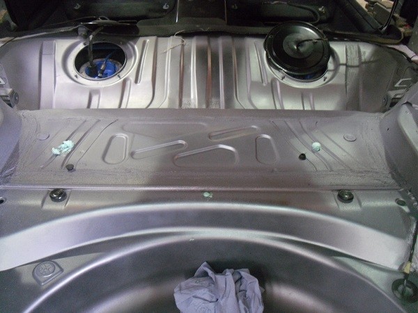

        The resin is done as well as the plates, or at least it was in my case, and across the entire floor. BMW only do the resin on the weak side unless you push them to do both.
          You got me worried for a second, but looks like they did both.
