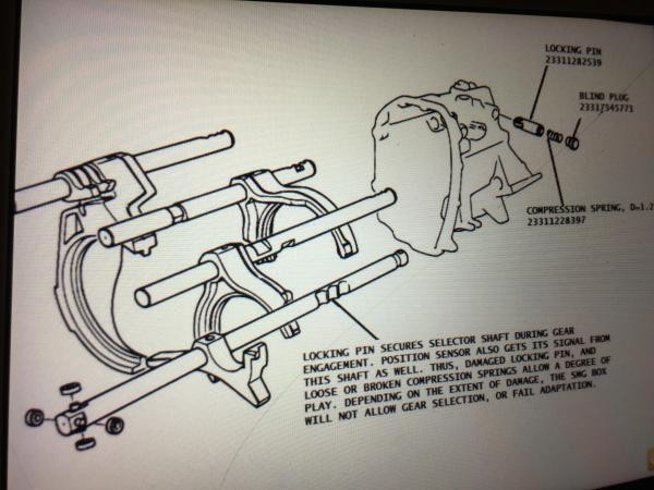

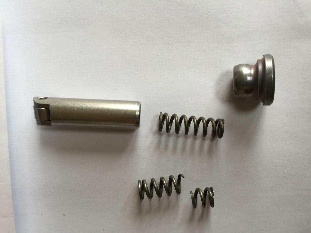

        ...this may help Compression spring can often be an issue. As text says weakening or broken spring , personally had this problem, locking pin can also be an issue, worn bearing on end of pin . I always keep a spare �� Cheers select managed to post a picture

            I think if the compression springs are at fault it would jump out of gears. at least thats what happened to me when mine were broken. But as i said, don't worry about it unless the issue creeps back.

              As select says hopefully nothing, busted spring tends to throw up cog light, but they can be hit and miss for a while when changing gear if spring breaks, until it throws a real wobbler
              But not a big issue for anybody to do themselves now, always worth bearing in mind before blowing tons of cash on other repairs to smg system :thumbs:
