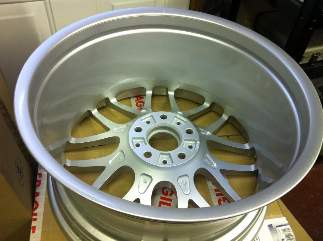

    Front

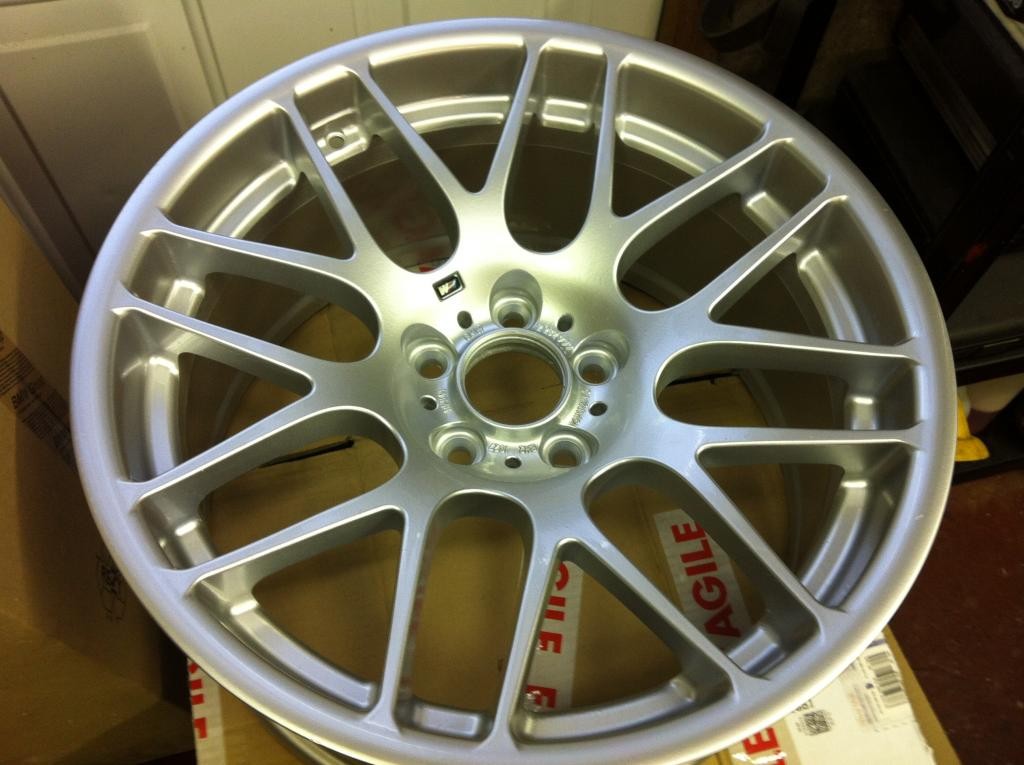

    Back

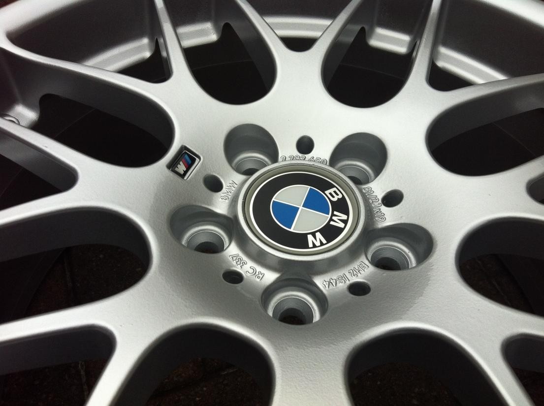

    Numbers on the wheel

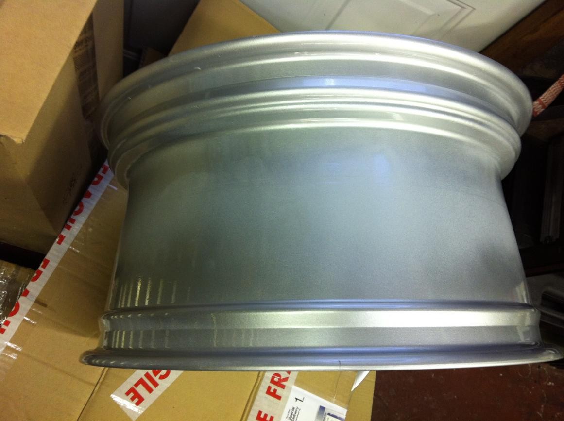

    Then the primer was applied to the whole wheel inside and out
    This was left to dry over nite
    Then the wheels were rubbed down with a red scotch pad again to key the primer them panel wiped down to remove any oils from the hands
    Then this Audi silver was applied to base the wheel and cover any small imperfections before the sparkling glass coat was applied
    Then the clear laqure was applied they should be dry tomorrow and i will get new badges put on and new center caps.

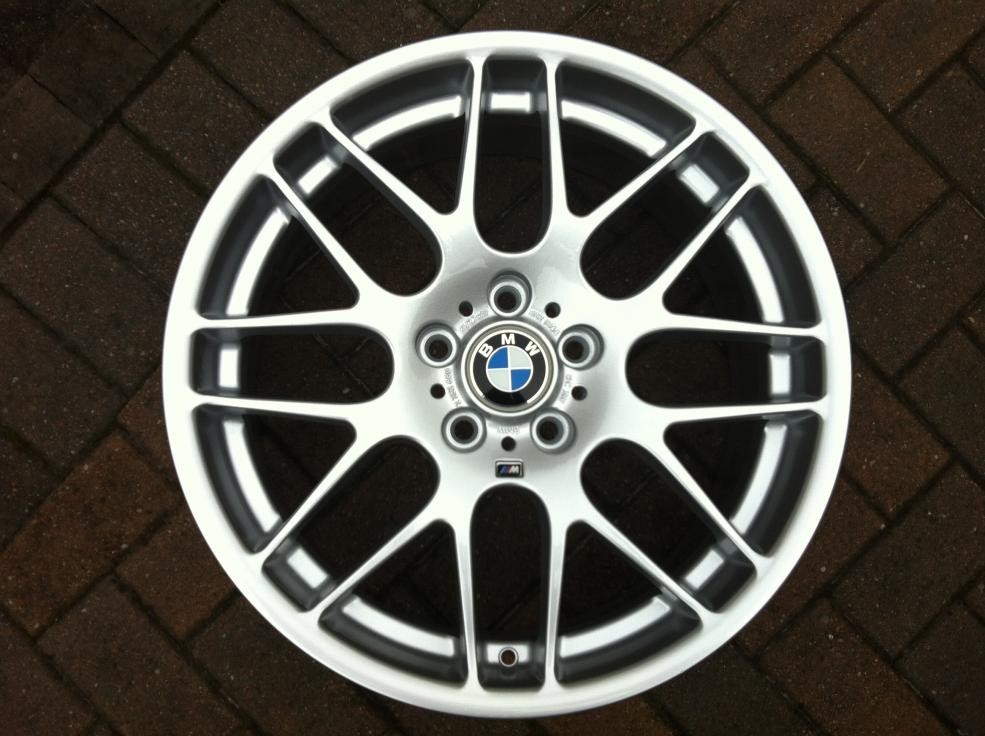

                  the finished wheels :-D
                    Nice job mark :thumbs:
                      Thanks Craig :thumbs:

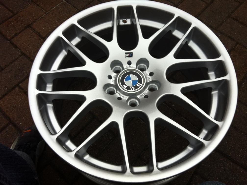

                      Couple more pix before the Tyre fitter marks them :whistle::bigcry::bigcry::bigcry:
                        You have lined up the M badge with the BMW badge too :thumbs:
                          Yes i know i just cant help it :-D
                            did you reuse the old Mbadge stickers ? If so , assume you just used a normal glue ?
                              The M badges were removed with a small chisel then popped back on with number plate tape :thumbs:
