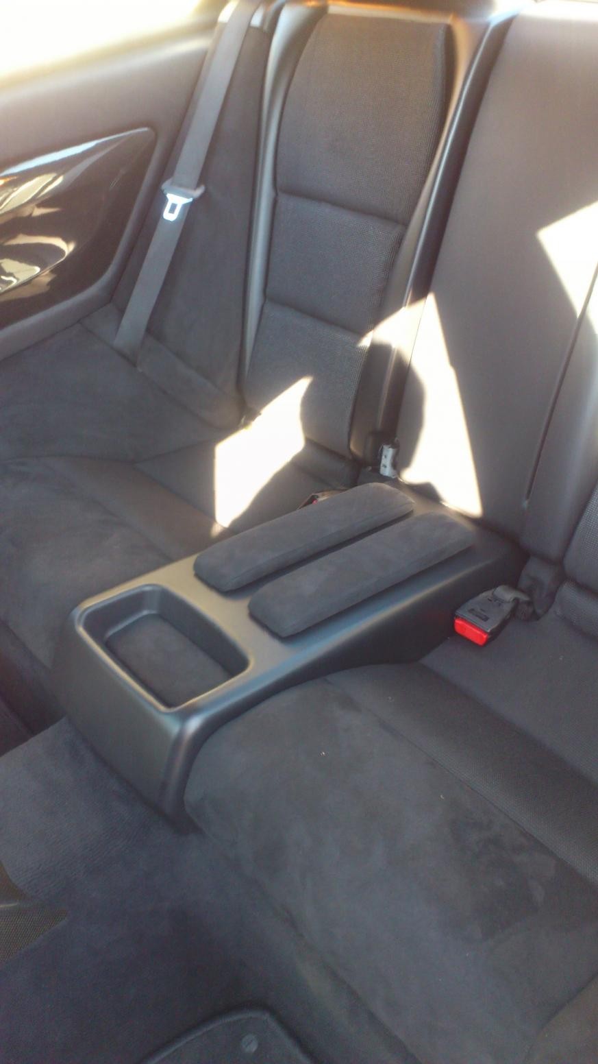

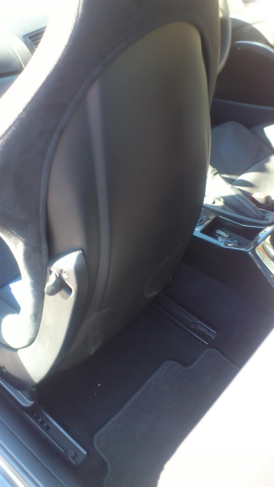

                  Just had the bootfloor replaced at vines in guildford and thought i would get a quote at the same time for a brush up on the seats trim mark the main paint man there said he could fix a small crack on rear centre console and save me a lot of the price buy doing the front seats whilst in the car he uses a special protection for this around the inside of the car plus my rear seats were loose anyway so that was easy enough a couple of pics not very good quality first pic has sunlight glare at the bottom but very happy with the outcome.
