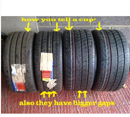

    Spotted these on ebay, anybody in the Andover area that would be able to collect these if I won the auction?

        Correct - BUT they are still the gay Cup+ rather than the full fat CSL Cups... :gayfight:
          Look at the tread pattern the are cup +
          And the ad states 265 x 35 which are E92 size 265x 30 is CSL size
          T$
            I sent the seller a question stating that they look like Cup+ to me... :whistle:
              I think TS is right,they are cup+,says so in the Q and S section below the advert.Also says 265/35/19 and not 265/30/19.Just make sure they are what you want before you pay for them mate.

                  They are cup+ if thats a picture of them they are good but not as good as the Cups the CSL came with.

                        there are two types of Michelin Cup tyre which have two different patterns and. rumoured. compounds;
                        Michelin Cup and Michelin Cup+
                        You can easily see the difference in the tyre pattern below(Cup left, Cup+ right). The Cup has a dual band thread and compaund where the outer is there for dry traction and the inner for wet traction. You can see the Cup+ has more grooves and therefore less rubber surface than a comparative Cup tyre. Also the extra grooves give more tyre movement and hence less heat and more lateral wear but better wet grip.
                        I have not seen it confirmed but the Cup+ is rumoured to have not as grippy rubber compounds (more akin to PS2).
                        The N0 or N1 prefixes just show they are Porsche Homologated tyres and ok for use on funny cars with big weights at the back! Strange thing is that michelin dont seem to add the + to the tyre when they list the N0 and N1 tyres even though they are Cup+ pattern, look at the stickers on the Cup pictures above, both just say Cup!
                          265 x 35 with a larger profile making a higher rolling circumference will mean your speedo under read's slightly, which in turn will make your miles clock up more slowly.
