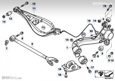

    I just got the Info from my local BMW dealer, that part Nr. 33322283074 is no longer aviable.
    Is this really true?
    Anybody got en Idea where to get these spares elsewhere?

    What part is it ?

        Part Nr. 5:

            bMw call it the WISHBONE Lower......
            No. Description Supplement Qty *From* *Up To* Part Number Price Notes Photo
            01 Trailing arm, left 1 33322229685 $768.41
            01 Trailing arm, right 1 33322229686 $768.41
            02 Ball joint 2 33326775551 $59.70
            03 Ball joint 2 33326775551 $59.70
            04 Rubber mounting 2 33326770817 $33.38
            Important!
            See information in the TI-column.
            05 Wishbone, lower 2 33322283074
            06 Hex Bolt with washer M12X1.5X80-10.9 2 33171090824 $5.15
            07 Lock plate ZNS3 2 33326760364 $7.03
            08 ECCENTRIC BOLT M12X1,5X98 2 33321095102 $6.78
            09 Eccentric flat washer 2 33306786186 $2.52
            10 Self-locking collar nut M12X1,5-10 ZNS3 4 33326760668 $0.62
            11 Wishbone, upper left 1 33326781625 $243.72
            11 Wishbone, upper right 1 33326781626 $243.72
            12 Rubber mounting 2 33321092247 $15.18
            13 Hex Bolt with washer M12X1,5X88-10.9 2 33321090693 $6.52
            14 Self-locking collar nut M12X1,5-10 ZNS3 4 33326760668 $0.62
            15 Hex Bolt with washer M12X100-10.9 2 33321094474 ENDED
            15 Hex Bolt with washer M12X100-10.9 2 33176760343 $2.05
            16 Bracket, left 1 33331096601 $17.30
            16 Bracket, left 1 33303411877 $21.21
            16 Bracket, right 1 33331096602 ENDED
            16 Bracket, right 1 33303411878 $21.21
            17 Collar screw M12X1,5X70-10.9 2 33326760389 $1.44
            18 Collar screw M12X1,5X43 ZNS3 6 33326760386 $1.31
            19 Pulse generator, ABS rear 2 34526752683 $165.65
            20 Fillister head screw M6X16-ZNS 2 07119901438 $0.60
            20 Fillister head screw M6X16 2 07129905536 $0.64
            21 Cable clip 15 34521164653 $0.23
              Buy some adjustable ones if you cant get OE stuff.

                  something like this?
                  to be true: They are way to expensive for me.
                    £300 for the pair.
