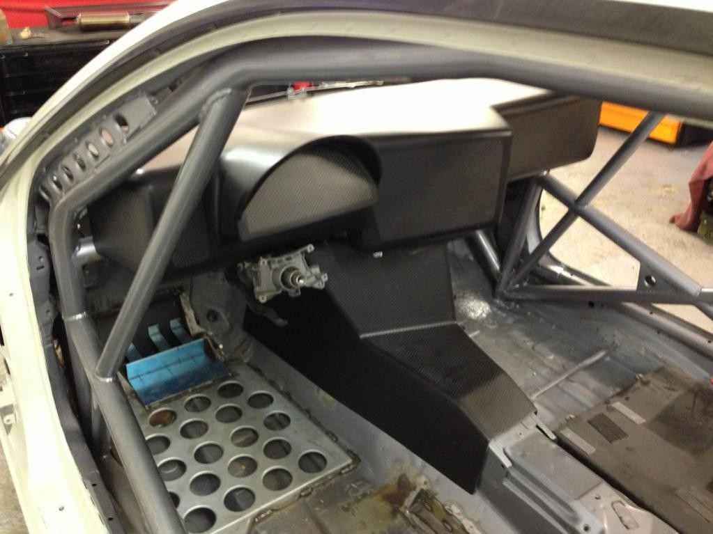

        Popped the dash in to see what it'll look like, I'm happy :thumbs:
        Bit of work left to do on the shell yet before paint yet though.
          Looks good cage looks well built too :-D
