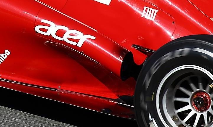

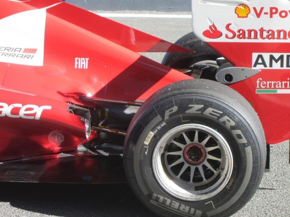

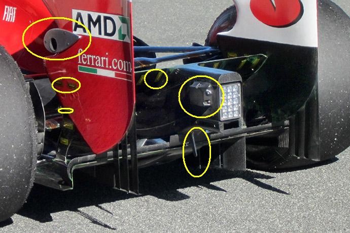

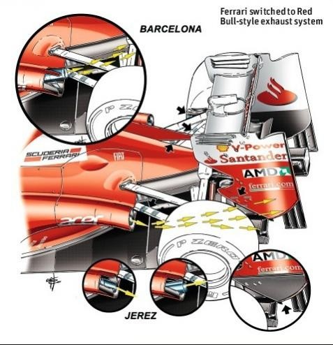

              Hi,
              AlexGTT - Some Therapy for You.
              Here is a Pic of the Fezza at Jerez, 'leased'
              from another Forum showing the set up at
              Jerez, where it was working very well but
              apparently heating up the Tyres to much.
              Moving it forward ala MaClaren for the max
              of the 'coanda' effect is the way the
              rummor mill is suggesting they
              will more than likely go.
              If the High Nose stays for 2013 then I doubt there
              will be anybody running a Pull rod front.
              Regards,
              The Gorilla
                I remember seeing these images on F1 Technical. That set up burnt the bodywork quite badly and you can see some extreme heat damage to the inside edge of the Ferrari's rear tyres.
