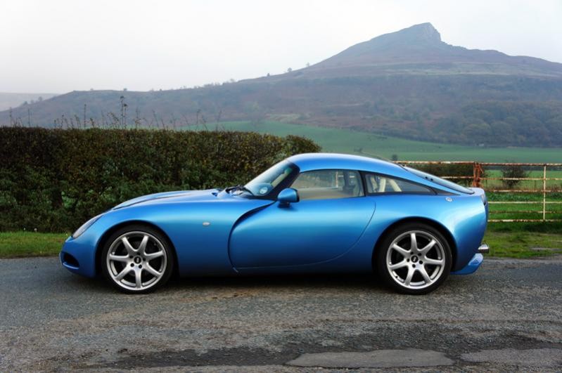

    Here’s a few quick pictures (no time for a photo shoot just yet!) of the new addition to the fleet; a late 2004 TVR T350. Its finished in Lotus laser blue with magnolia over blue hide interior, it’s currently on 19,000 miles and is in outstanding condition given the cars age.
    It’s been mildly fettled, like most TVR’s have parts seem to get replaced with superior after market items. At the moment it’s running GAZ Gold Pro Coilovers with a geometry set up from X-Works Service, has a JP Racing Exhaust complete with ACT De-CAT’s and a TVR Power De-CAT EPROM chip to suit... safe to say it’s got a nice noise to it!

    Very nice!! :beer:
      Looks nice :thumbs:
