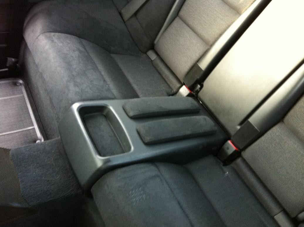

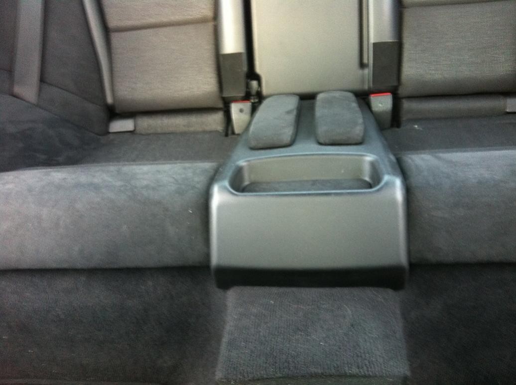

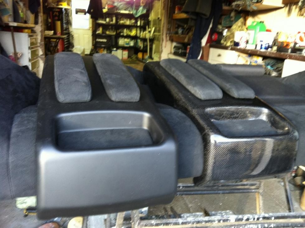

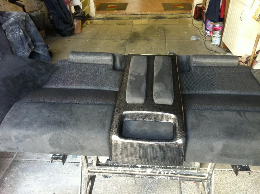

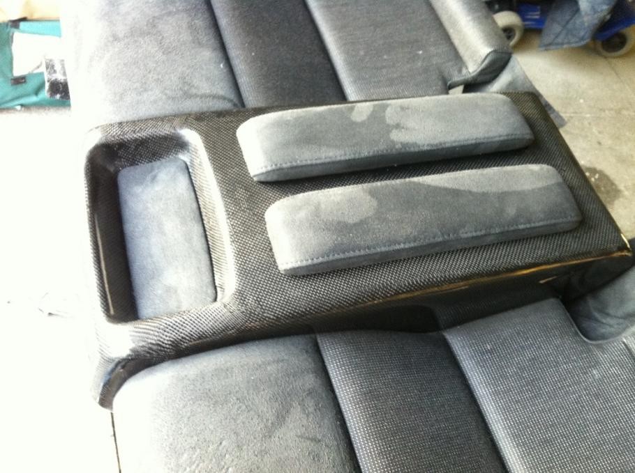

    This is the back seat laminated with carbon it was a cracked one before i started
    I will let you know how to remove it form you csl should you want this done

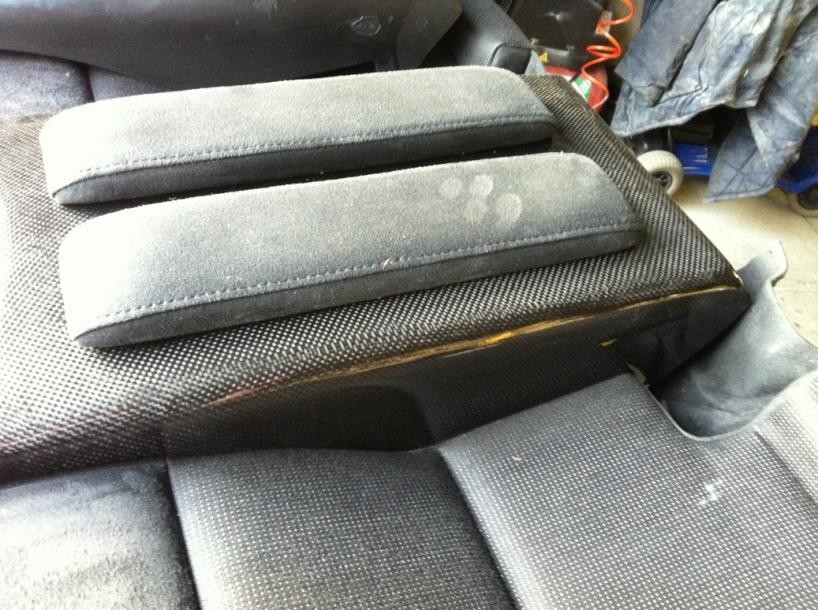

    Remove the seat from the car
    on the back of the center part you want to remove is a ring of metal just open it a little so you can get the seat off picture

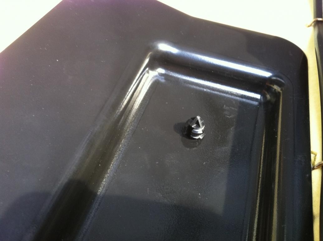

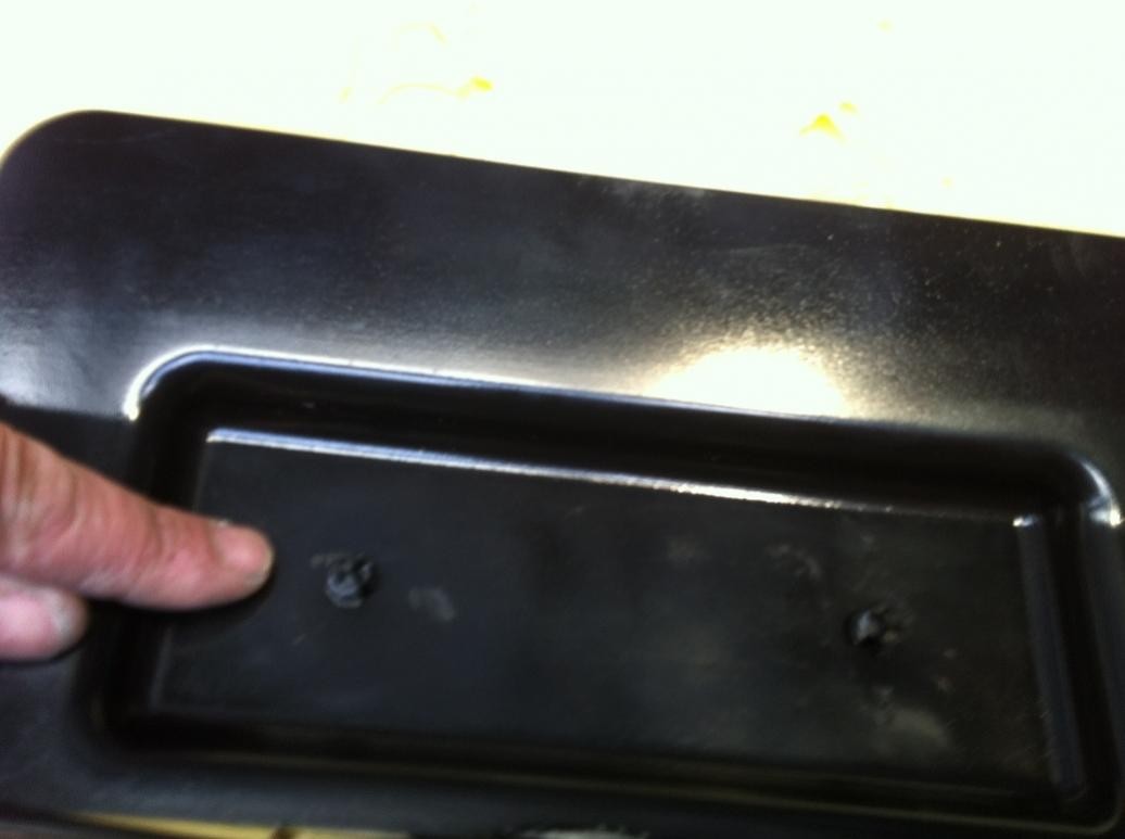

    Then on the front bottom part there is a large plate of plastic with 2 push clips from the tray part u put my hand under the plastic part and hit the clip with a hammer they pop out with the tray part picture

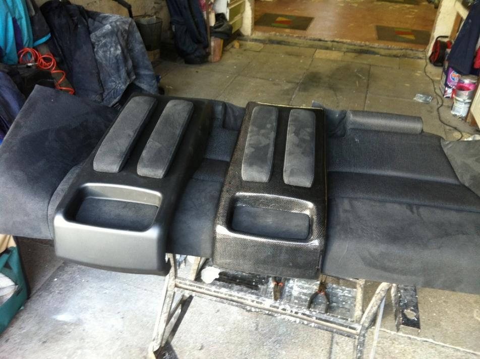

      Here is my seat out with the 2 parts sitting on the seat

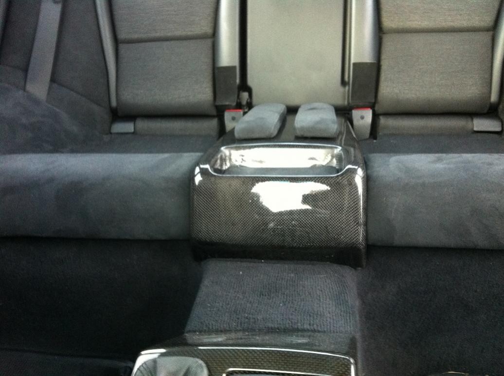

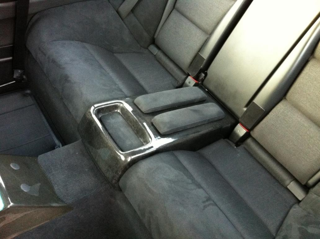

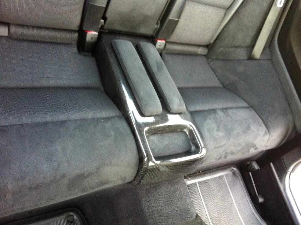

        Before and after in the car :whistle: what do you think
          Very good Mark,i want one:thumbs::thumbs:

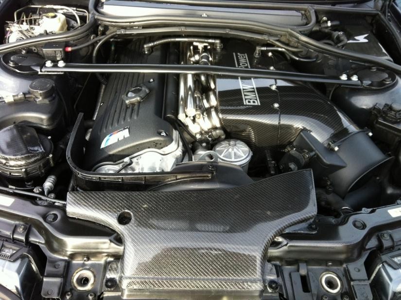

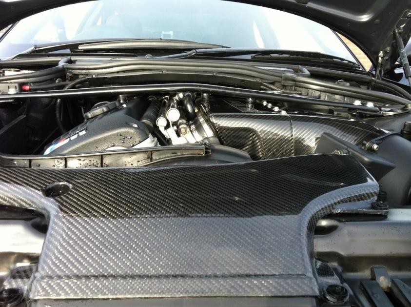

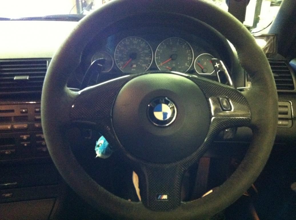

            This was some other parts i did as well
              +1 for rear seat console in CF :thumbs: It's what BMW should have done in the first place.
                The big upside is it wont mark as easy and if it get scratch it easy to clear coat and i have added strength to the part that cracks :supz:

                        Alex i think the best way is to laminate the original part and it will keep the cost down as its less carbon or you could make it in fiberglass with a coat of carbon might look into this i have not given up on the mold just yet

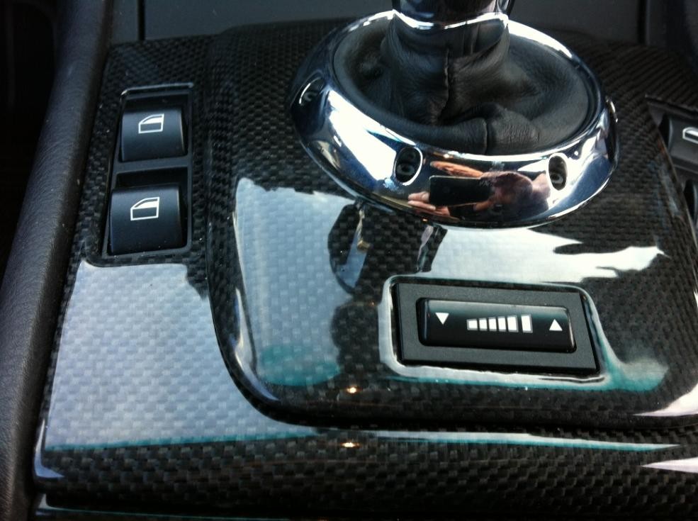

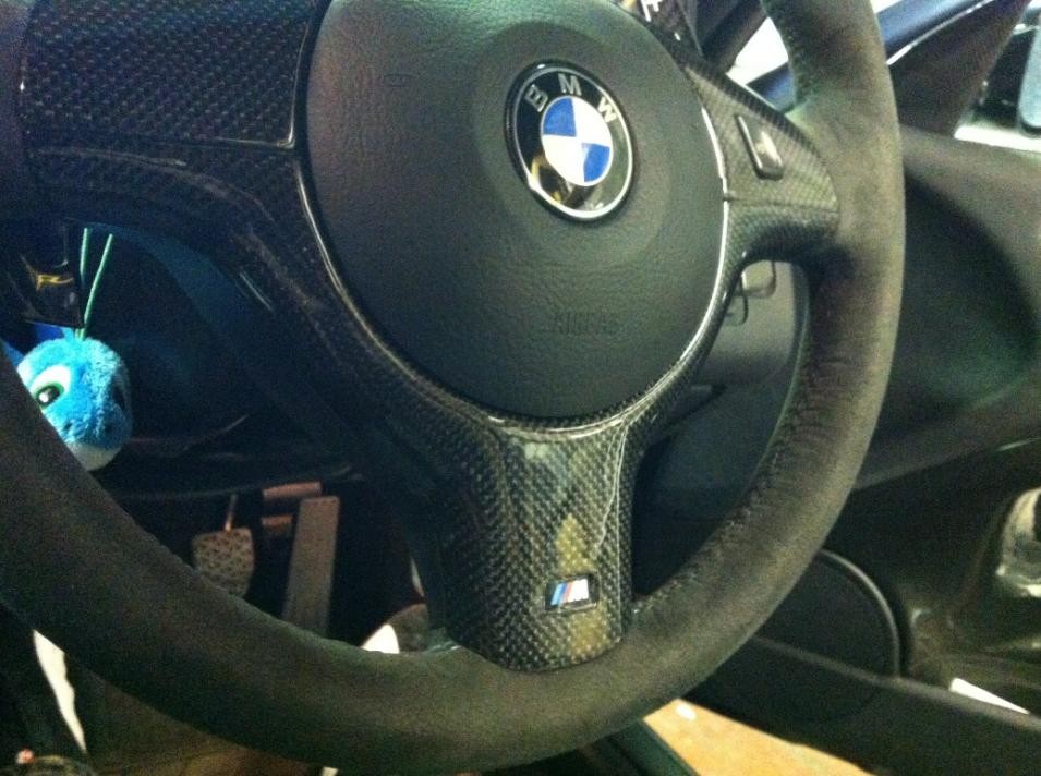

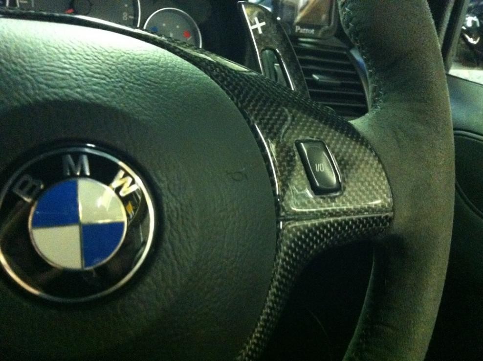

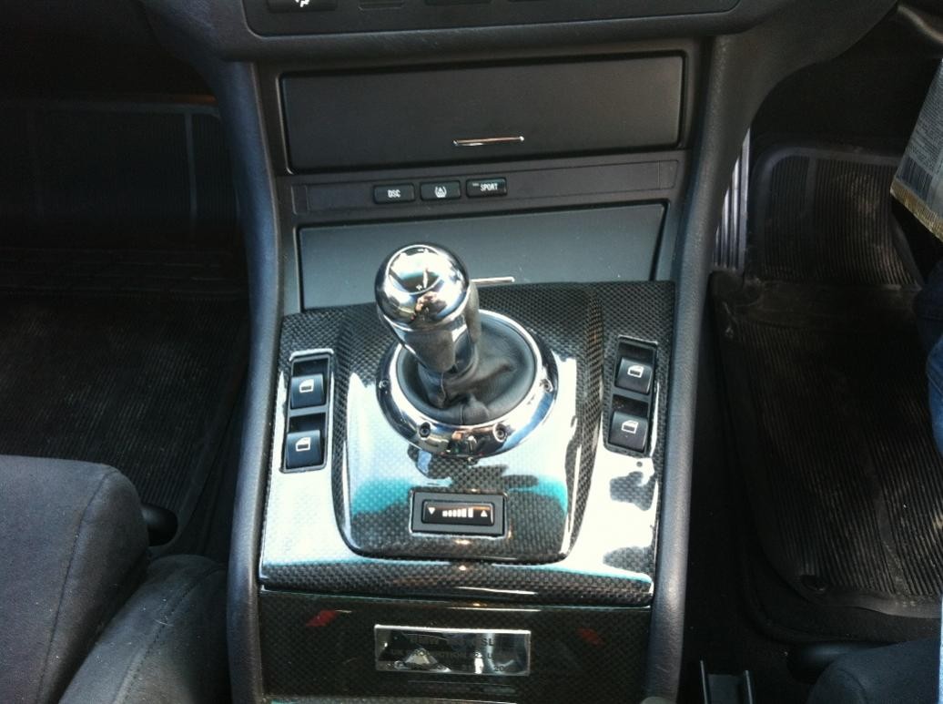

                              This was my latest carbon mod I bought an old set of trims that were scratched 5 days later i have these not to every ones taste i am sure
                              but i think they are sexy in carbon :thumbs:
