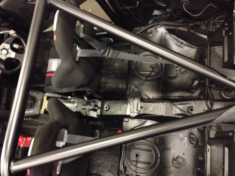

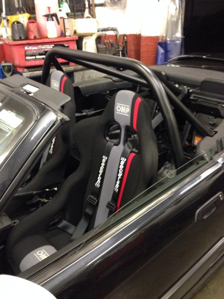

Ive just finished the cage in A&B Racings convertible 328i
Feels a bit more solid on road now car still runs and drives superb. Attachment omitted from migration

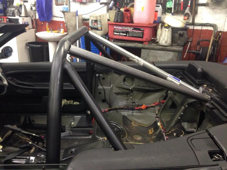

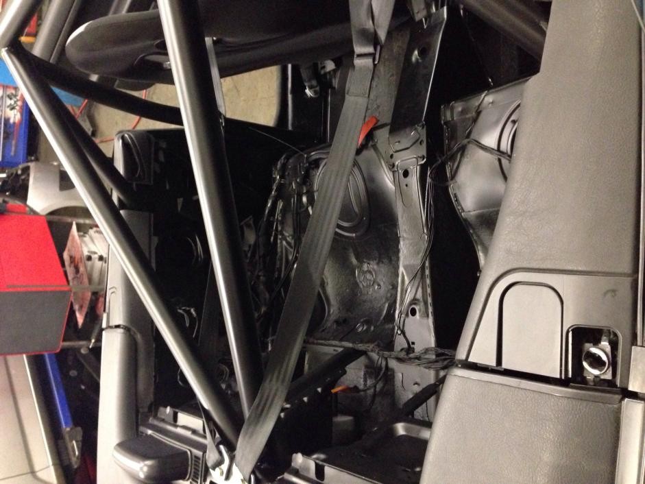

That one i made from a pre fabricated hoop the made the 4 other bars myself cutting shaping them so that the fit tight onto the main hoop then welded it all in.
This was the mock up took 3 hours to get them close!
When i finished welding it in i used 2 engine cranes and lifted the car off the floor by the cage just to see what would buckle!!
Not even a crease!
