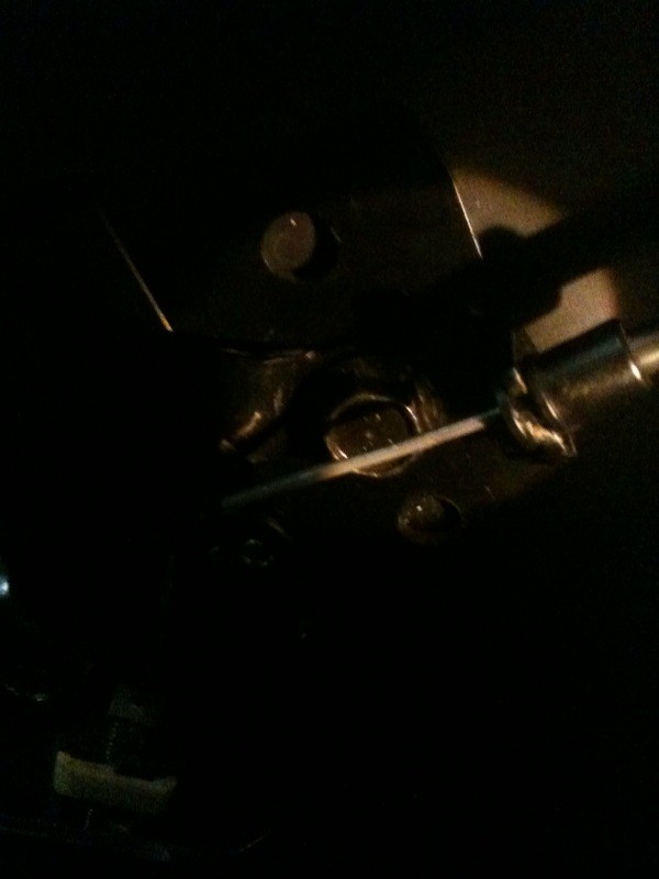

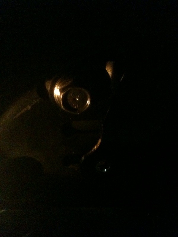

    This might sound like a stupid question but can you see what setting the seat is on before taking anything apart?
    I have tried a couple of times but couldn't really see - however, that was before I saw that drawing and knew exactly what I was looking for (it is obviously too dark to go have a look right now :whistle: )
