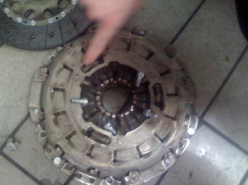

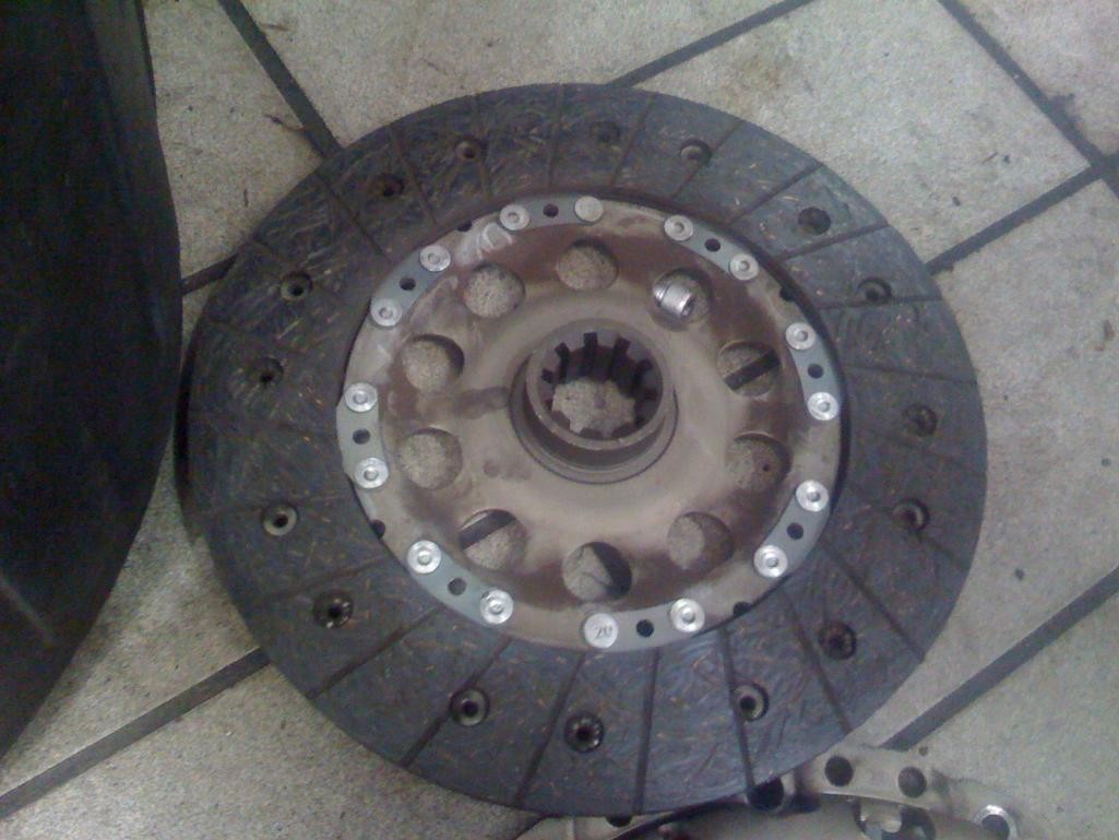

    This was the clutch that was slipping after the new engine went in
    You can see the springs that take up the slack
    You need a better camera Mark :hahaha:
    The springs in the pressure plate is the self adjusting mechanism - basically allowing the pedal travel (if it had a clutch pedal) to be consistently the same throughout the life of the clutch kit.
    There's a reset tool that they use to reset the self adjusting mechanism when the pressure plate goes back on.
    You should check for heat spots on the flywheel and the friction surface on the pressure plate.

    What a good clutch plate looks like
