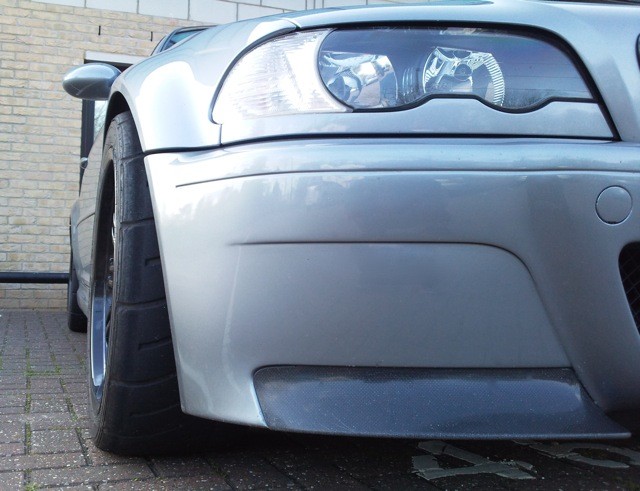

    Hi,
    I am getting some new tyres for my 9" all around setup and am not sure whether to go with 255/35 or 265/35. I am running -2.5" degrees of camber and with the ET26 offset of the 18" wheel I think the 265 might just be a bit too wide, but then again the diameter of the 255/35 is a lot smaller than standard than I want to go. Any advice?
    Thanks

    I run 265/35/18 ET26 9Js all round for TD work only, on standard -1.5" cumber & suspension set up and have no problems (no rubbing) so far, after 55 laps @ the Ring and one UK TD :thumbs: Front end grip levels are phenomenal :supz:

      I am a bit lower which is why I was worried about rubbing the arch lip. I guess with -2.5" I should be OK. What tyres did you have again? I am thinking about federal 595rs.

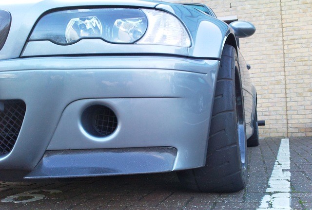

        i run now 265/35x18 up front on et34 with -2 camber and it works fine BUT when i ran my 265/30x19 on et27 with -2 deg it did touch the arches, but ok -3 (so -2.5 who knows)
          Thanks. Did it touch the lip or in the inner arch? How low are you?

              both - on full lock they just touch the front inner arch (but not a problem) but at -2 they also just rubbed the lip of the arch, front ride height is 643mm

                          my front rims are et37 9,5J and i managed to only put 3mm spacers on to clear the strutt. If i hadnt have chnaged the strutt follower spirng i may have needd 5-7mm spacers making it et30-32 which with 9.5J i still think will fit with -3 camber as well as -2 camber
                          et27 9.5j doesnt fit with -2 camber 9hits the arch lip)
