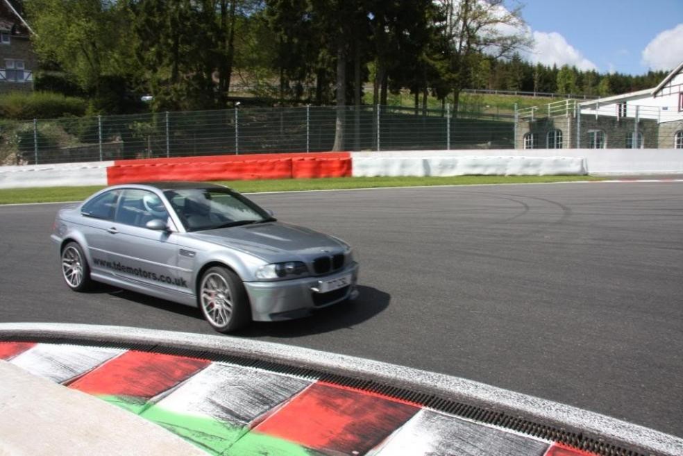

    Suspension wise, you might want to lower it a tad and certainly run stiffer than equivalent OEM. Regarding camber, i run more -2.5deg as standard but don't drive my car so much on road these days. I did Spa last year on OEM suspension and the car was rolling quite badly in the slower corners like 'La Source' hairpin and 'Rivage'.
      Short clip from last year - filmed at La Source and the start/finish straight.
        Body roll! Tim (E46ACS) at La Source.
