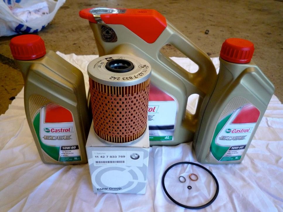

    I changed my oil and filter today as the car is at the mid-point between services and i wanted it in tip top form for the Ring/Spa trip next weekend.
    This was going to be a full 'how to' with photos but i found loads of similar stuff online already. So, i have simply listed that here for others to have easy reference. I found this a very straight forward job and it took about 45 minutes to do. :thumbs:
    It was a fair bit cheaper than a BMW oil service too:
    6 Litres of Castrol Edge 10W-60 - £56.65
    BMW oil filter change kit - £11.43
    Here are a couple of links that i found useful:

          mmmm just 6 litres Rob?? aint that about 0.5 litre light ya skinflint ! :thumbs:
            How much are you putting in - 6 litres? My manual says 5.5 litres.
              The 0.5 you keep it in the boot for adding
