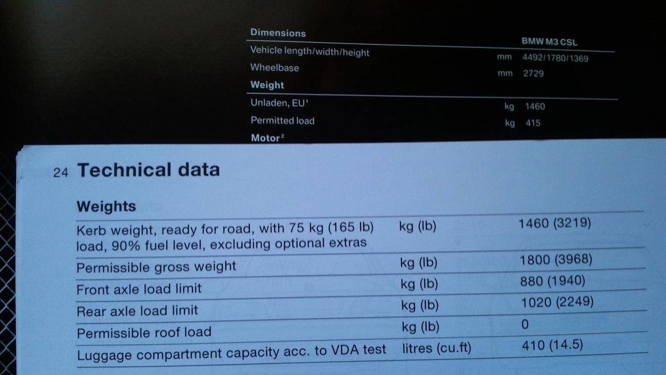

                    I guess the official BMW M3 CSL brochure is WRONG then :smt017 as is the supplementary Owner's Handbook for the BMW M3 CSL, where it says, and I quote:
                    Weights
                    Kerb weight, ready for road, with 75 kg (165 lb) load, 90% fuel level, excluding optional extras ....... kg (lb) 1460 (3219) :whistle:
                    Where are you getting your numbers from mate ?
                    Picture of the 'real' figures below :whistle:

                        It's not 1460kg, it's 1385kg with driver and luggage.
                        Hypothetically, 'mine' should be 1300 with full tank (without me inside) at this moment.
                        1385 Inc driver and luggage :hahaha:
