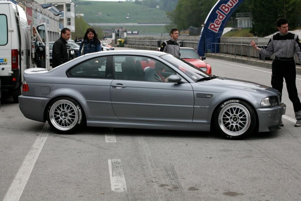

I have BBS E88 wheels with machined hubs to match E46 offset :thumbs:

BBS ch 19 x 9,5” et 40 with a 12mm spacer giving et of 28mm with a 265 cup tyre. This will be within 2mm of your KW clubsport springs.
Negative points
You will need to borrow “Glendogs” :smt055 hairdryer to stop the plastic lining form touch the tyres on full lock.
Maximum speed through the Foxhole is 140MPH, the out tyre hits the front part of the outer front wing.
Slower track time on the Ring and spa due to drag and over steer.
Positive points
Faster lap times on shorter twister circuits
Longevity of the front tyres.
Looks like” Duncan” A little over weight or short fat & round lol :smt055
