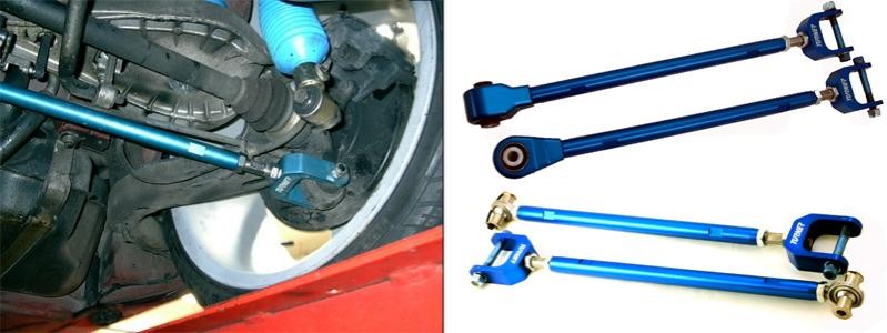

    I know the rear control arms on a CSL have a degree of adjustability - to what amount of negative camber can they be adjusted?
    I know my rears have -1.6 degrees setup at the moment but i may have to increase that to fit my rear track wheels (18x10.5J) under there...!
    I have the chance to acquire a set of the Turner Motorsport camber arms at US price - is it worth fitting them or a total waste of money?
    Also, what end would be best, rubber bushed (presumably) or solid?
    Turner adjustable camber arms
    Think you can get 2 degrees on the OEM ones, turner ones are stronger as well as more adjustment, that is what I am using now.
      got -2.15 dialled in on mine at the min mate.:thumbs:..... another half a turn and the fookers will probably drop out !:hahaha:
