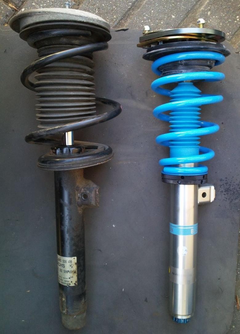

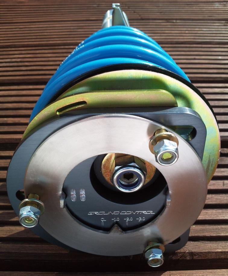

Self locking nut, V shape washer in the O.E. position, O.E. rear top mount, Bilstein supplied flat washer, shock absorber.
I presume this arrangement is OK too :thumbs:

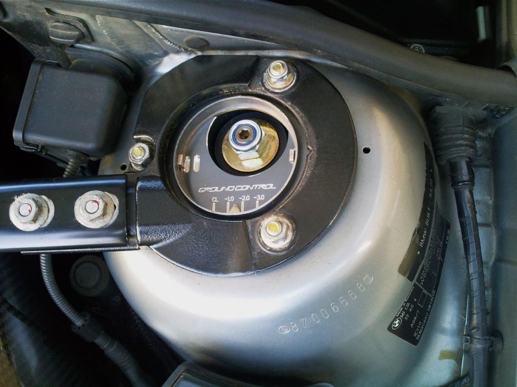

I'll have full alignment done once the front Billys are On and see how accurate my G.C. top mounts are :banghead:
