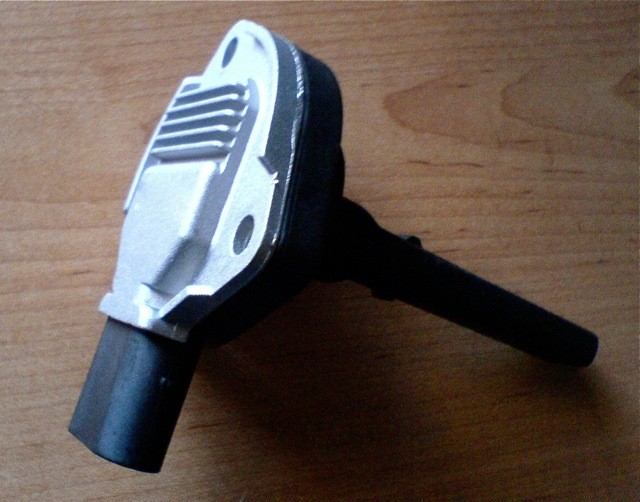

            The level sensor is located in the bottom of the sump, a little away from the drain plug, so waiting for an oil change would make sense.

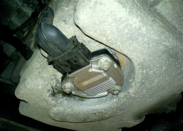

                Pix below shows the oil level sensor and it's location, albeit on my old E46 320d :clown: but you get the idea.

                  Yep, Gareth kindly checked the oil level (again) using the old fashioned dip stick & the sensor will be changed at the annual oil change.

                          It works by applying a voltage to heat the sensor and calculating the time taken to heat it to a set temp , the higher the level the longer it takes to heat thus it calcutates the level . Thats the simple way of explaining it .
