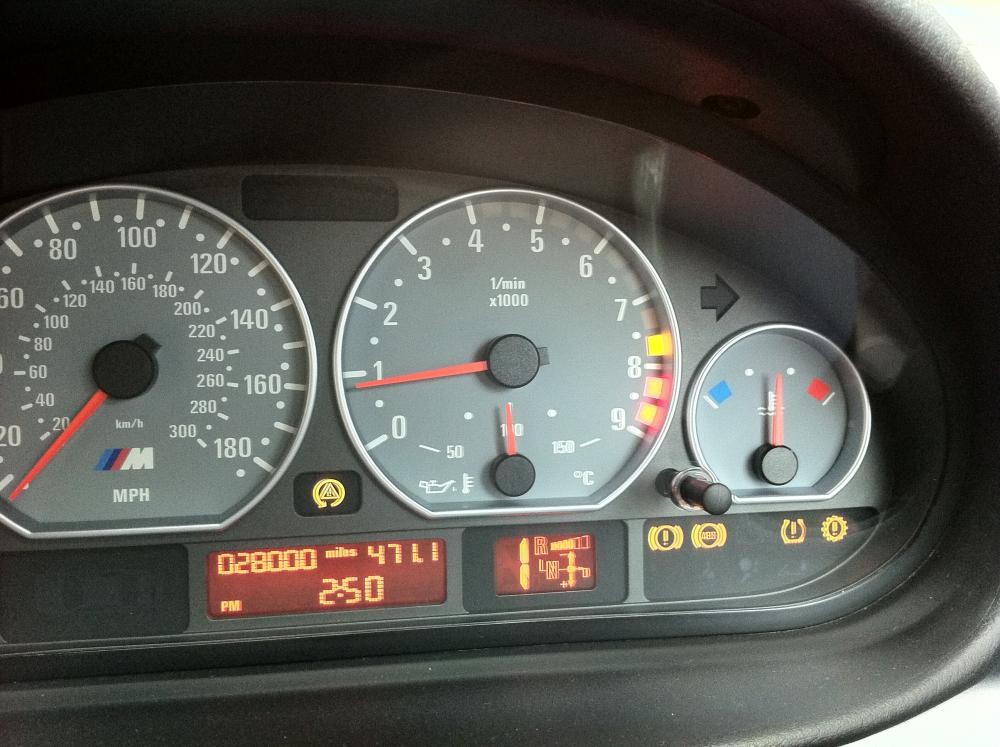

    Hey guys, please kindly help, got this crazy xmas tree going on my lovely CSL.
    Probably a wheel speed sensor[ABS] common fault.
      Tyre pressure light also on. This is an indirect pressure sensor which runs off the ABS sensors. It basically looks at the speed of each of the four wheels and takes the wheel which is turning slower than the rest, which would probably be the one with low pressure. So my guess its ABS related, suspect number one being a sensor or cut wire.
