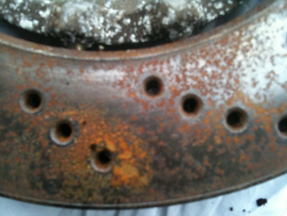

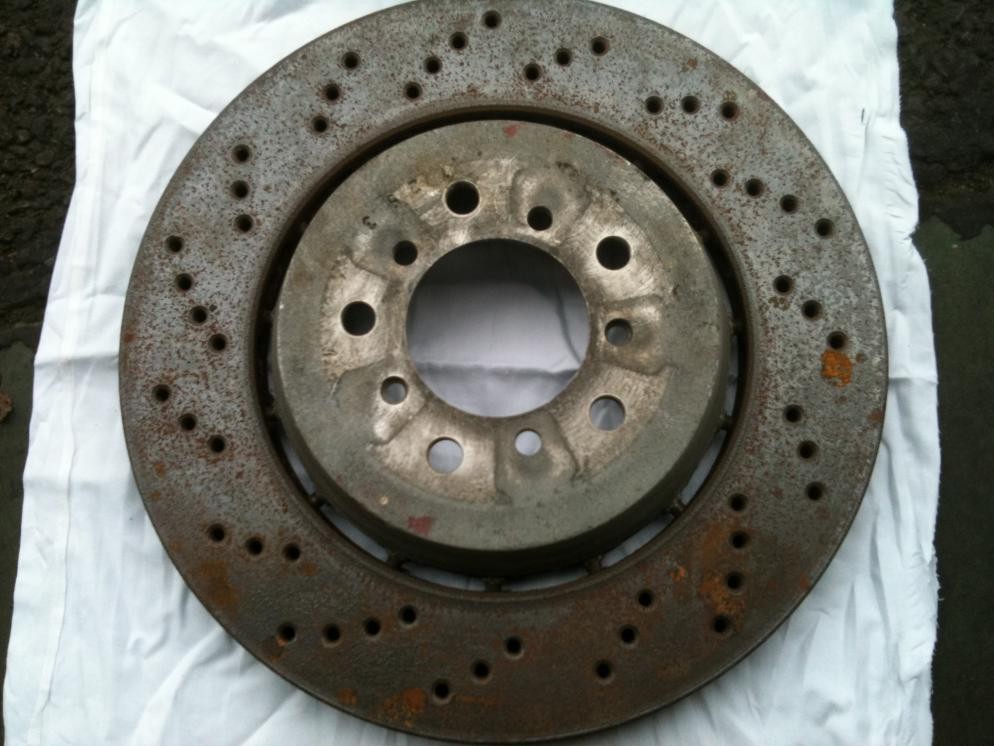

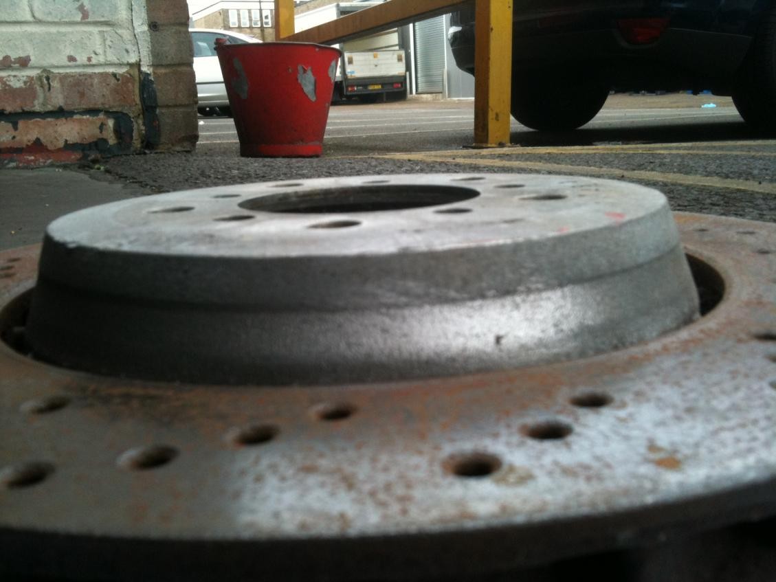

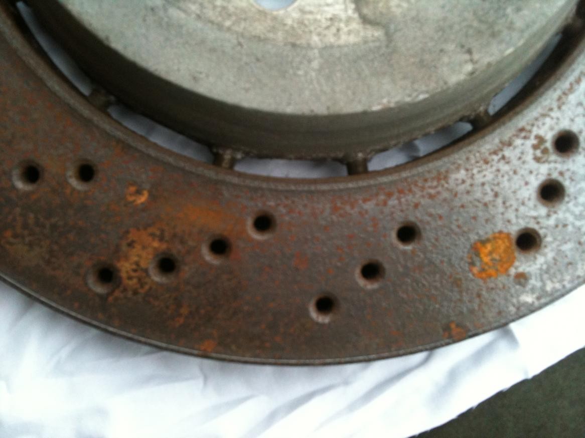

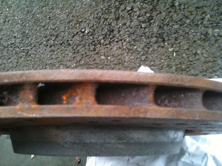

Do these look salvageable?
Any recommendations for someone who can refurb them for me near Iver Bucks?
Cheers

What size are they? They are csl disks or normal m3 disks, not that expensive from memory.

They look standard discs, wire brush the outer and a bit of emery on the face and they will be fine after a couple of stops.

Bilt Hamber Deox is great for getting rid of rust..... if you want to be more OCD than S.Mac's cheaper method - result will be the same tho

if you really want to use them, stick in old set of pads and see how shiney they get

What Shimmy said + by doing this you'll find out if they are warped or not :thumbs:
