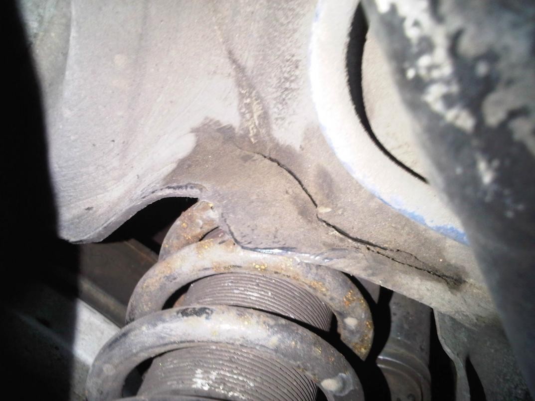

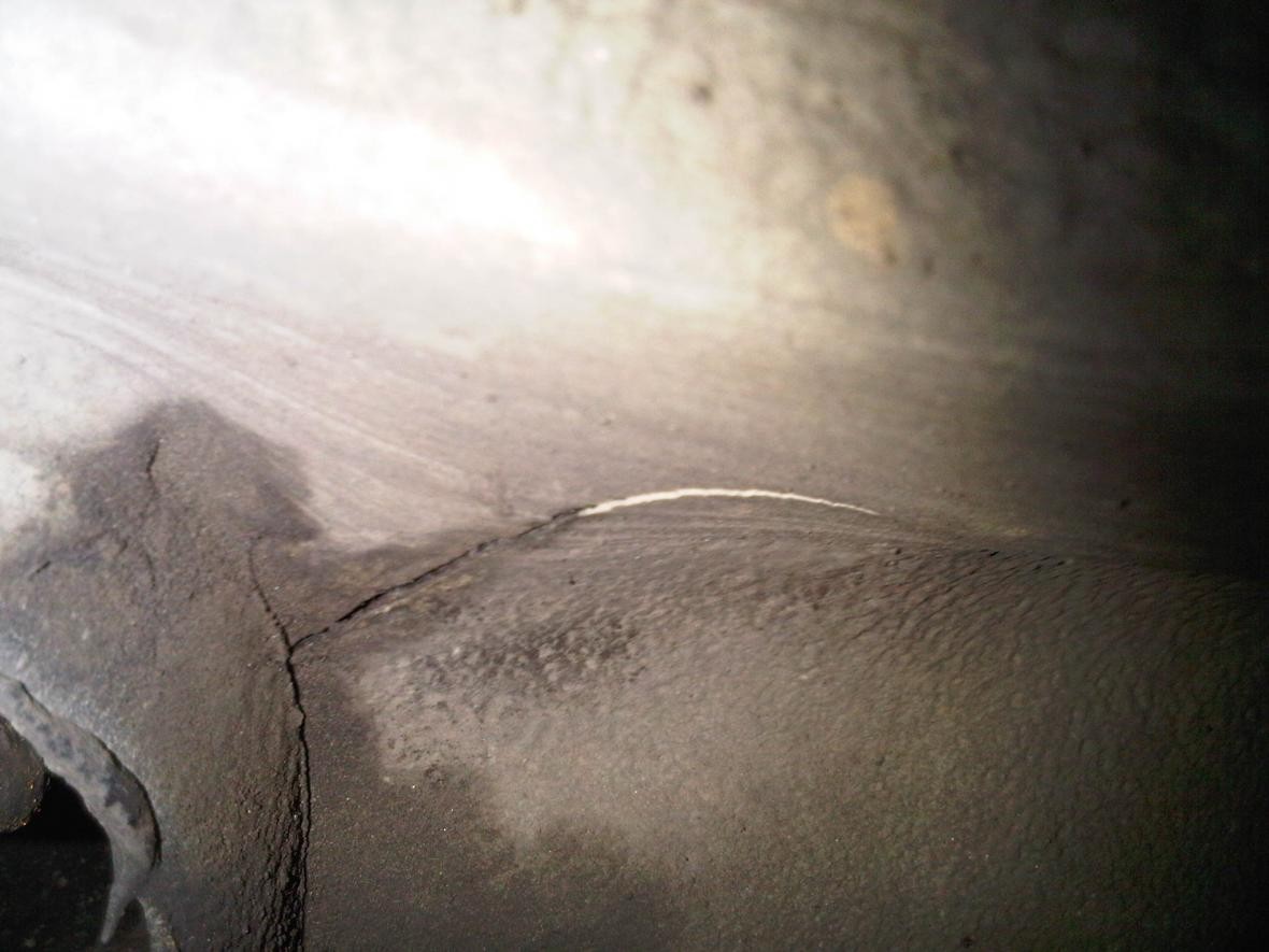

Discovered this crack last week, is this in the right area to be classified as the usual type of cracking. Bear in mind that my car is caged albeit the cage does NOT pick up onto the turrets, which is a shame.
The bottom pictures is taken from the Offside of a UK car, looking out and up towards the wheel , its on a seam, under normal circumatnces I would drill the end myself now to stop it going further, which it may have done after this week-end ! But as its under warranty still Im loathe to do so. Thoughts oh wise expereinced crack heads
No Dunc, they are cracks in the bottom floor pan mainly, not the subframe. They start near to the subframe mounting points typicallyOriginally posted by DuncanR View PostAlso, can someone clear up the confusion re subframe and/or floor pan, people seem to generalise and refer to "subframe cracks" whereas mine are clearly floor pan/body, is it the case that the actual subframe itself also gets cracks ?
