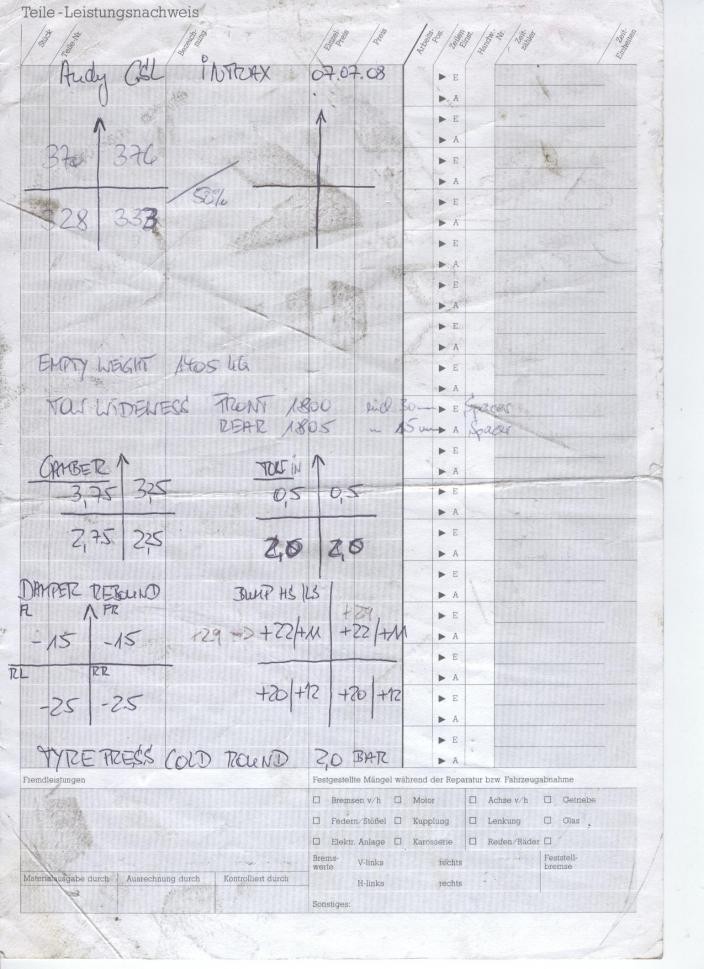

All I have is here failed... my battery was OEM weight one too, suspension is Intrax.
Car is stripped of rear seats and all carpets, but has a roll cage in it and the front seats are out replaced with Recaro Pro Race ones.
Corner weights are at the top, with a total weight of 1405 kgs.
