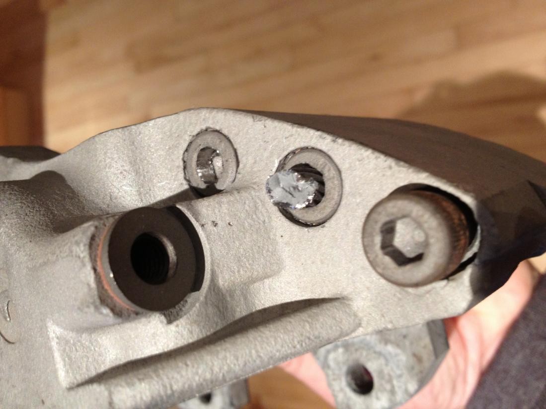

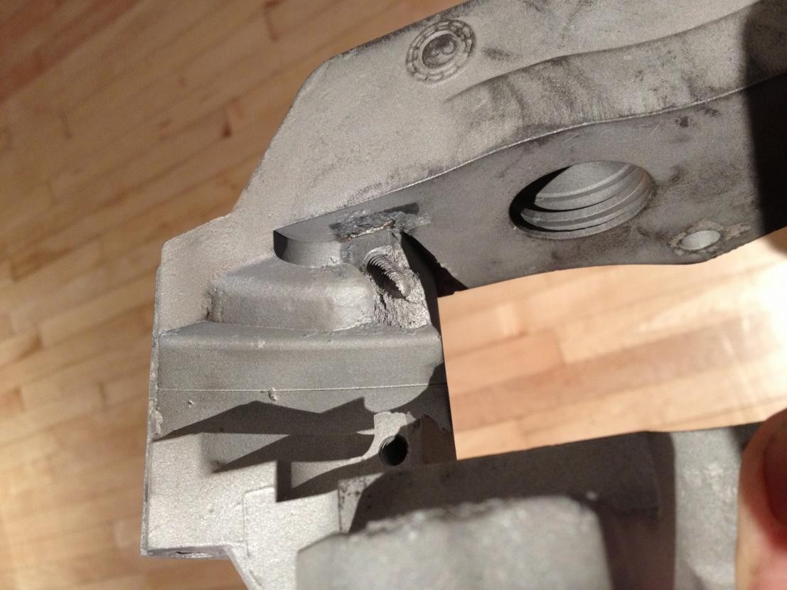

    I finally got my APs back. To be fair one of the rear callipers was seized, by that I mean all the bolts had seized in the alloy. I had to buy a new one when attempted removal of a bolt resulted in the alloy snapping.

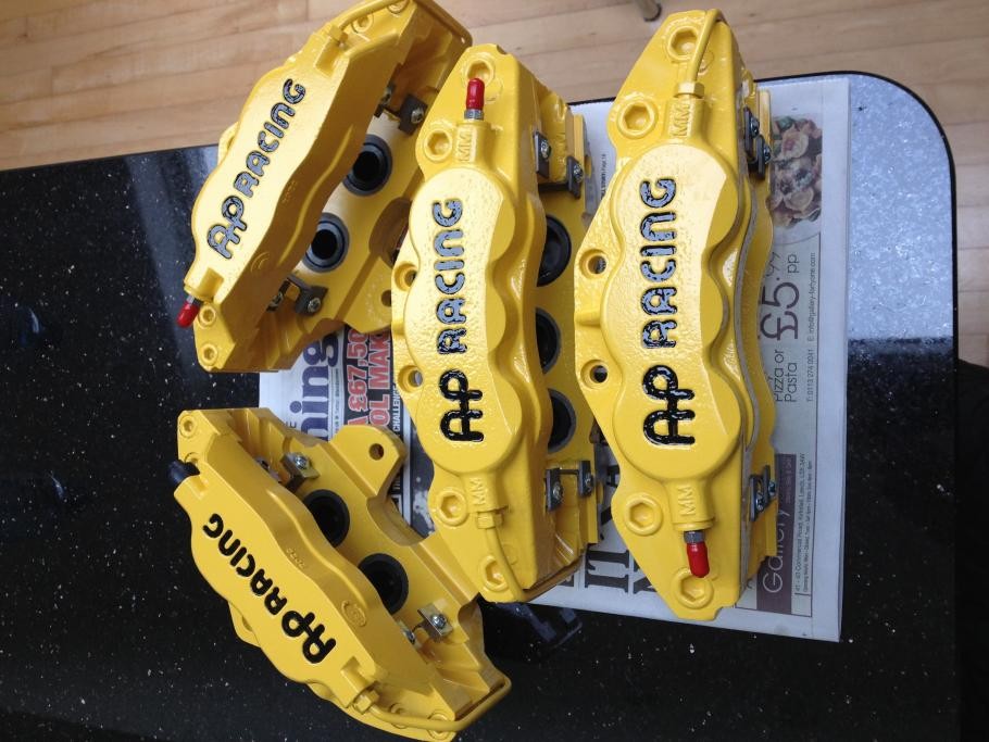

    I'm not sure I have a before shot but here's the after.
    I am going to get the AP logo painted in, black.
    Seized bolts apart from one and snapped alloy from the pad retaining seized bolt

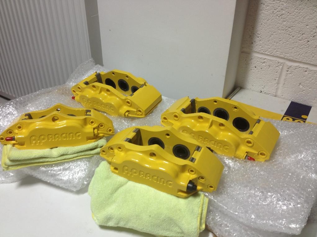

      For some reason I can only upload 1 pic, here's the other

          Work done
          Callipers stripped and cleaned, I mean fully stripped, check all parts, piston/seals replaced where or what is needed.
          Then all paint removed, looks like a powder base coat applied to the calliper that's fooked.
          Then final paint of the colour you've chosen, just no decal paint applied.
          Looks like new pad retainers and bolts fitted as well.

                      It's all in, I know they charge for alloy pistons but that's on oem stuff if you want an upgrade.
                      The bolts and anti rattle clips have also had a base coat to get the rust off.
                      They did say mine was the 1st Ap that they couldn't get apart to split and in Bens words, he's done hundreds, just my luck....
                      Worth a call if you need a service. I can't believe how the alloy can corrode, sort of pitted in places.
                      My turn around was slow, I'm not sure if they thought I was going to kick off about the damage but if it was seized then what could they do.
                      They tried all the normal procedures and just couldn't get the bolts free.
                      Once we discussed options and I told them to give it their best shot, which failed and I got the new AP rear turn around was quick.
