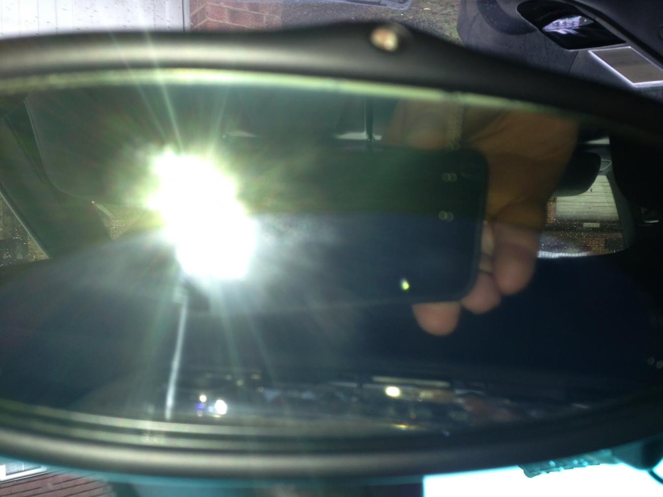

    here the picture of my one i am off back to the dealership as just had some warranty work done on it and asked them to check over anything else and they missed this (was not there though to be honest on sunday) only noticed it as i was driving off from the dealership.

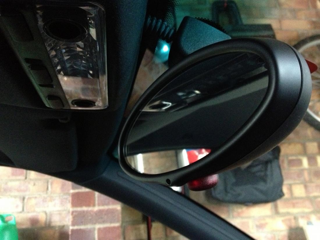

      After reading this thread I thought I'd pop into the Garage and awake my hibernating Cecil
      Had a close up look at my rear view mirror and sure enough it seems to have similar issues. :banghead:

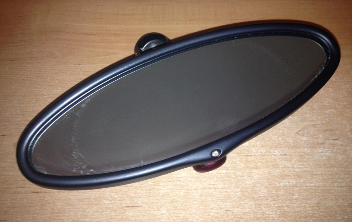

      Took it off straight away, just incase it decides to pee itself. Pix below.
        Highly Recommended to all CSLR members

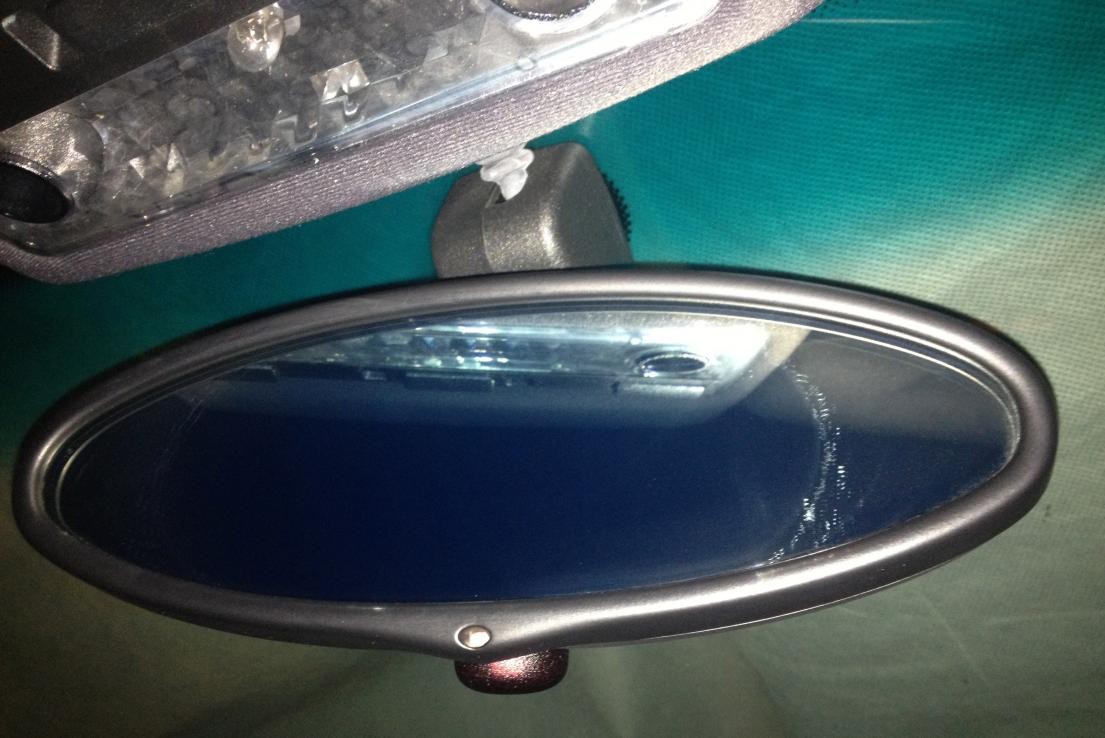

        +1 :thumbs: for http://www.radar-mirror.com/Mirror_Repair.html :thumbs: Here's my most excellent experience.
        After discovering what was the very beginnings of my CSLs internal rear view mirror leak I email Scott @ radar-mirror with a couple of pix of my mirror for his inspection.
        Sure enough Scott replayed straight away to confirm my suspicions.
        So off to Texas my mirror went via Parcel Force AIRSURE Tracked mail @ £17 (insured for £250) It arrived in the USA few days later and was promptly repaired more or less the same day (with a lifetime warranty) and posted back a day after.
        The whole process from start to finish was extremely smooth, Scott replays to emails swiftly and kept me informed at all times.
        Total cost for return postage & mirror repair was $144 USD, $99 of which was for the actual repair and $45 for USPS Recorded & Insured postage, easily settled via PayPal. Total door to door turn around time was almost 2 weeks however over a week of that was down to the UK Customs who held onto my mirror before billing me for VAT on the Total US spend ($144) which worked out @ £27 (£8 of which was Parcel Force handling fee)
        Total cost of return postage, repairs & VAT in GBP was £141.65 ...
        Before deciding to go with Scott @ Radar-wirrors repairs, BMW very kindly made a " Good will " offer but that unfortunately was almost double of my total repair costs. Incidentally to buy the whole NEW M3 CSL mirror outright from BMW would have been in excess of £400 :119: minus any dealer discount you may get.
        This seem the obvious way to go for anyone who's Cecil is either out of warranty or in excess of 60 000 miles which automatically voids any interior trim Warranty claims regardless of what Warranty level cover you have.

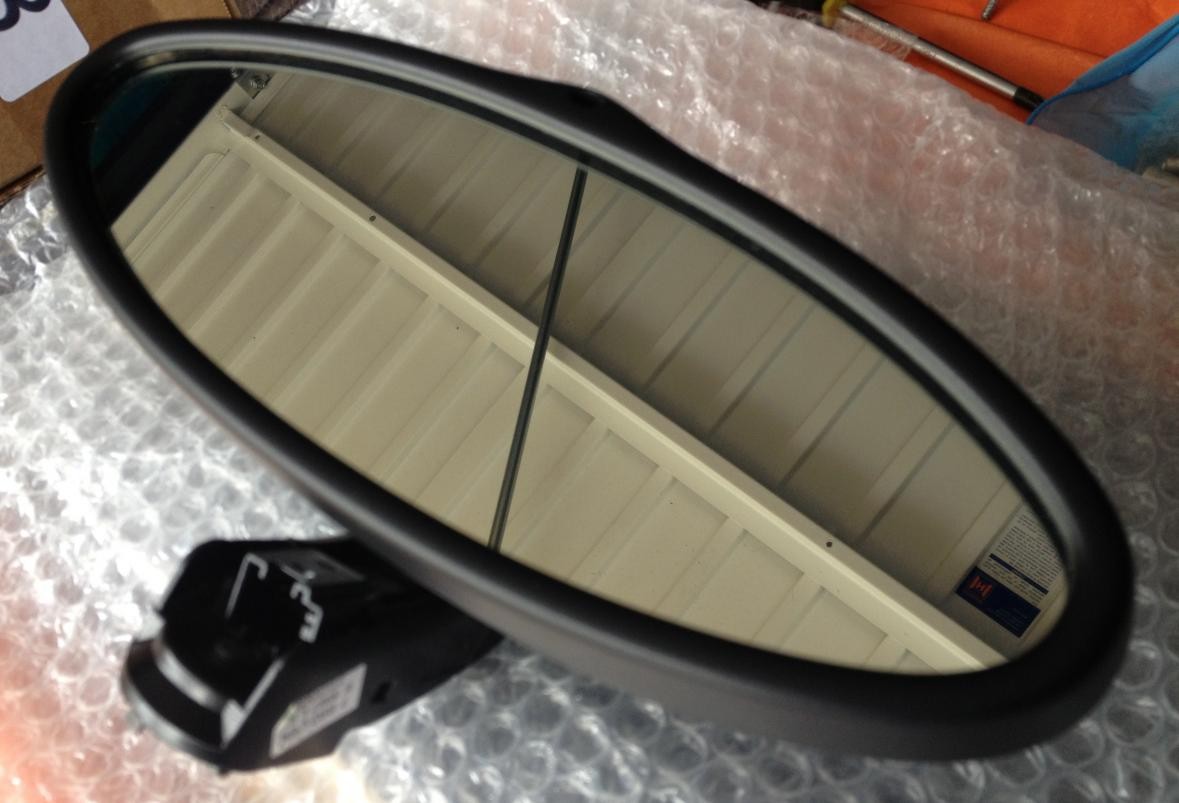

        Few pix of the repaired mirror back in it rightful place :-D
          i got a new one with my warranty as it does not dim when its like that cost £00000:thumbs:
            I WANT NEW MIRROR! :thumbs:
            nice one MAtt
              Lucky yours is just under 60K miles Mark

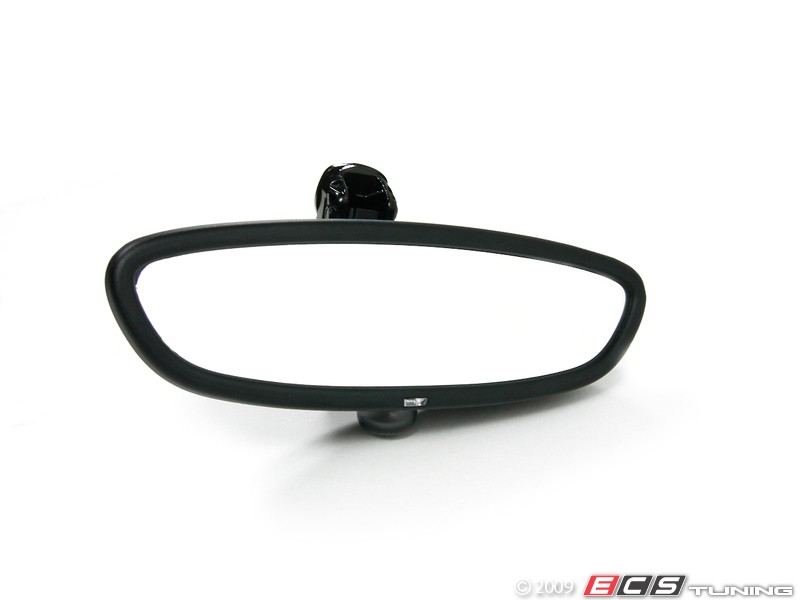

                                hi guys, a quick question..
                                does BMW UK have in stock / can source the oval rear view mirror?
                                I was told that the oval ones are discontinued and these (photo below is from google images) are the only available replacements:
                                cheers,
